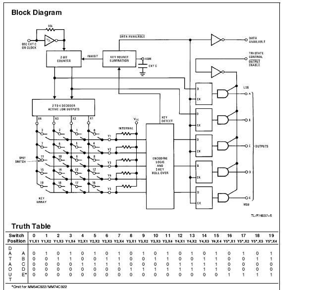

Download the 74C922 datasheet from www.datasheetarchive.com
It shows examples on how to connect a 4*4 or 4*5 keypad.
I have used the 74C922 in early projects, but they are not cheap, it would be more cost effective if you used the MCU to scan the pad.

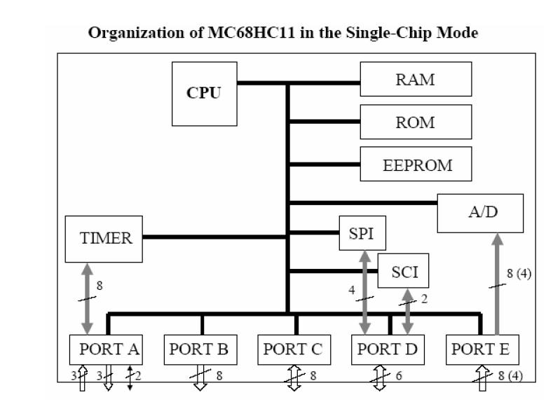

thanks for 3v0 reply and i now have an Idea about it, this is the diagram of 68HC11 organisation Org Of 68HC11.JPG after i hv got the idea from 3v0, i wish to do this following jobs if i apply the Port C (Bi-directional I/O) with use of the IC MM74C922N which the diagram of bottom, do it make sense? IC config.JPG
Thanks ericgicbbs ur reply I hv download the above datasheets so may i know that do it possible if i connect the Port C (PC0 - PC3) to the IC MM74C922?
You can do whatever you can get to work.
If this is a learning exercise then I would scan the keypad with the processor. if it is a project where you need to conserve you ports for other hardware I would use the MM74C922N or some other decoder as suggeted by Chris.
