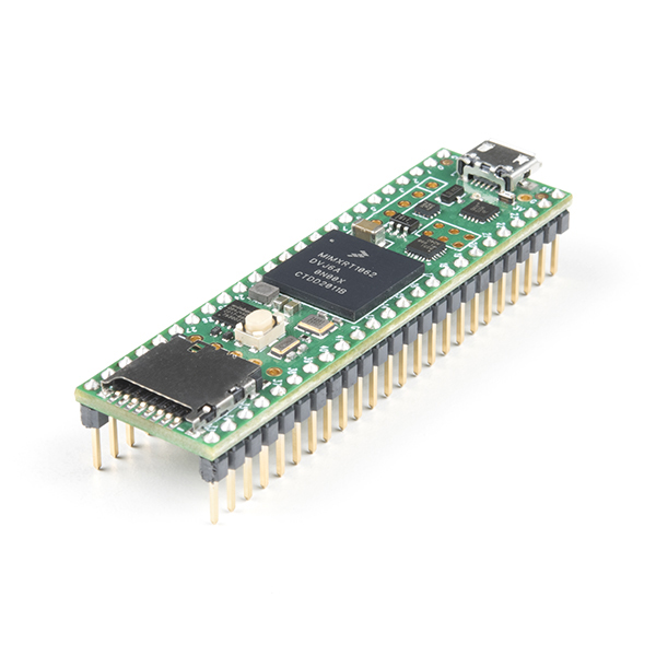

There are a number of large computers on boards like this. This one is a 600mhz ARM computer. Will it count as a through hole micro-computer?
