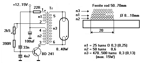

please can someone help with the circuit diagram of a 6v electronic flourescent inveryer circuit.
i will be glad if the details are provided.
thanks
My cct. work fine in my van with 12V supply, and the pot can adjust the brightness. It's quite simple, i'm sure possible modify for 6V use.
