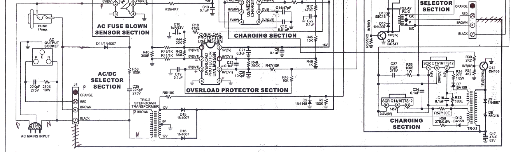

eg.
Sine Wave Inverter Circuit using PIC16F72 – Making Easy Circuits
DIY Cheap 1000W Pure Sine Wave Inverter (12V to 110V/220V)
DIY Cheap 1000W Pure Sine Wave Inverter (12V to 110V/220V): Car batteries for powering you home? Build a low cost 12V to 220V (DC-AC) Pure Sine Wave Inverter from scratch! The project is based on the low cost EGS002 SPWM driver board module. The DIY inverter board can handle up to 1kW (depending...
