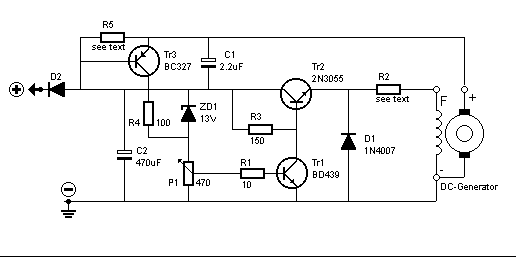

http://www.next.gr/uploads/135-11129.png
R10 controls the voltage setpoint.

Although the reg in Tony's second link provides voltage regulation, be aware that it doesn't provide current overload protection so doesn't wholly duplicate the mechanical regulator functions.
That looks a better bet, but would need to be adapted for a 6V system.
The field winding has one end (marked Df in the post #5 wiring diagram) which goes to the F terminal of the mechanical regulator. Can you confirm if the other end of the field winding is hard-wired to the D+ terminal or to the Gnd terminal/frame of your generator?
Resistance meter confirms that the D+ terminal is grounded.
