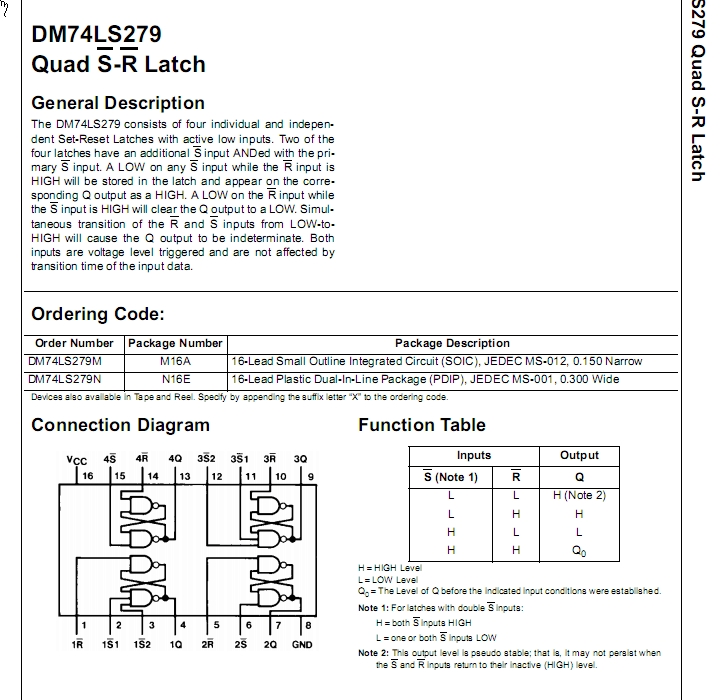

The LS279 are quad NAND gate type latches.
To Set a latch to a high '1' output the SR input/s is switched low '0' and it will remain Set until the R reset pin is switched low.
This means when the SR input low level has set the latch output high, the SR input can go high again but it will not reset the latch, only a low on the R input will reset the latch.
You need to detect the leading edge of a switch press, use the edge to Reset all the latches, after the edge reset the latches will be set to the BCD patter of the pressed switch.
From the Truth Table I know that the latch will set if S=0 and R=1 ...if they're both 1's latch memorizes last state and continuous so, if they're both 0's it causes an invalid state because we don't know how Q is going to be(at least at this kind of latch) ...
What you're saying should be wrong from the truth table.

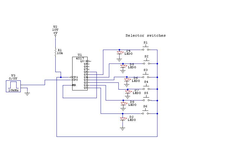

another way you can think of it is to latch your inputs when the button is pressed, it can be done using a 4017 with a fast clock. when you press one switch the particular out put will come high and remains until you press the other button. see the attached cct.
Edit: missed to attache the cct.

4017 is a decade counter, but can be used as i mentioned, i recently made such a selection latch for a school exhibition project for my daughter, it works fine.
if you follow its very simple to understand how it works. the enable input should be kept zero to enable the counting, here its connected to supply voltage via a high resistor, when a particular button is pushed then it makes the enable input to go low making the counter to count, until the particular out put connected to the push button becomes high then the counter enable goes high. this stops the counter on that state.

this drawing i made for another post long before for some one who needed channel selection for 6 inputs, the feed back resets teh counter after 6th LED, even you can keep it not connected sop that it would go until 10counts to internally reset. using one IC you can go up to 10 LED / out puts, there is a way you can connect two ICs and go up to 20 selections, that is what i made recently for my daughter.
The idea is good but the circuit you provided is wrong ...since CP1 will never be low so the counter counts ...?
Why does the button when pushed , make CP1 low ...
This circuit doesn't work.

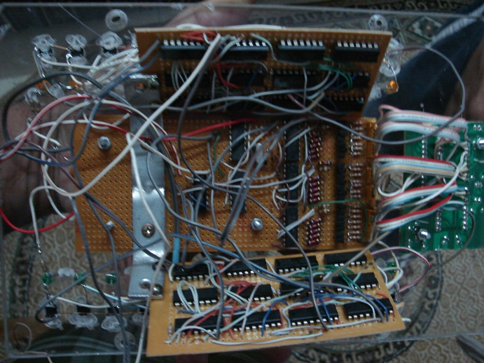

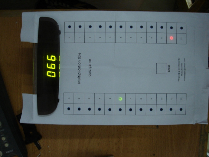

it may not work for simulations, but it works in real, see the attached pic of some game i made for my daughter, it just work fine without any problem, when ever a push button is pressed the LED lights up for that selection.
CP1 is the enable input of 4017, and can be pulled to low when connected to any of the out put that is low (current sink).

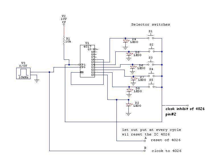

I used 4026 (counter & 7 segment driver) for the display....great the same you can use it to diplay the numer of the selection of 4017, do as on the attached diagram, my program doesnt have 4026 in the library so coudnt complete the drawing, check the data sheet for how to connect it.
CD4026BE Datasheet pdf - CMOS Decade Counter/Divider with Decoded 7-Segment Display Outputs and Display Enable - Texas Instruments
when you press a push button either it will reset 4017 IC before lighting the LED or wil not reset, in both cases the display 4026 will show you the selection number.
Edit: new diagram attached to inhibit the clock to 4026
