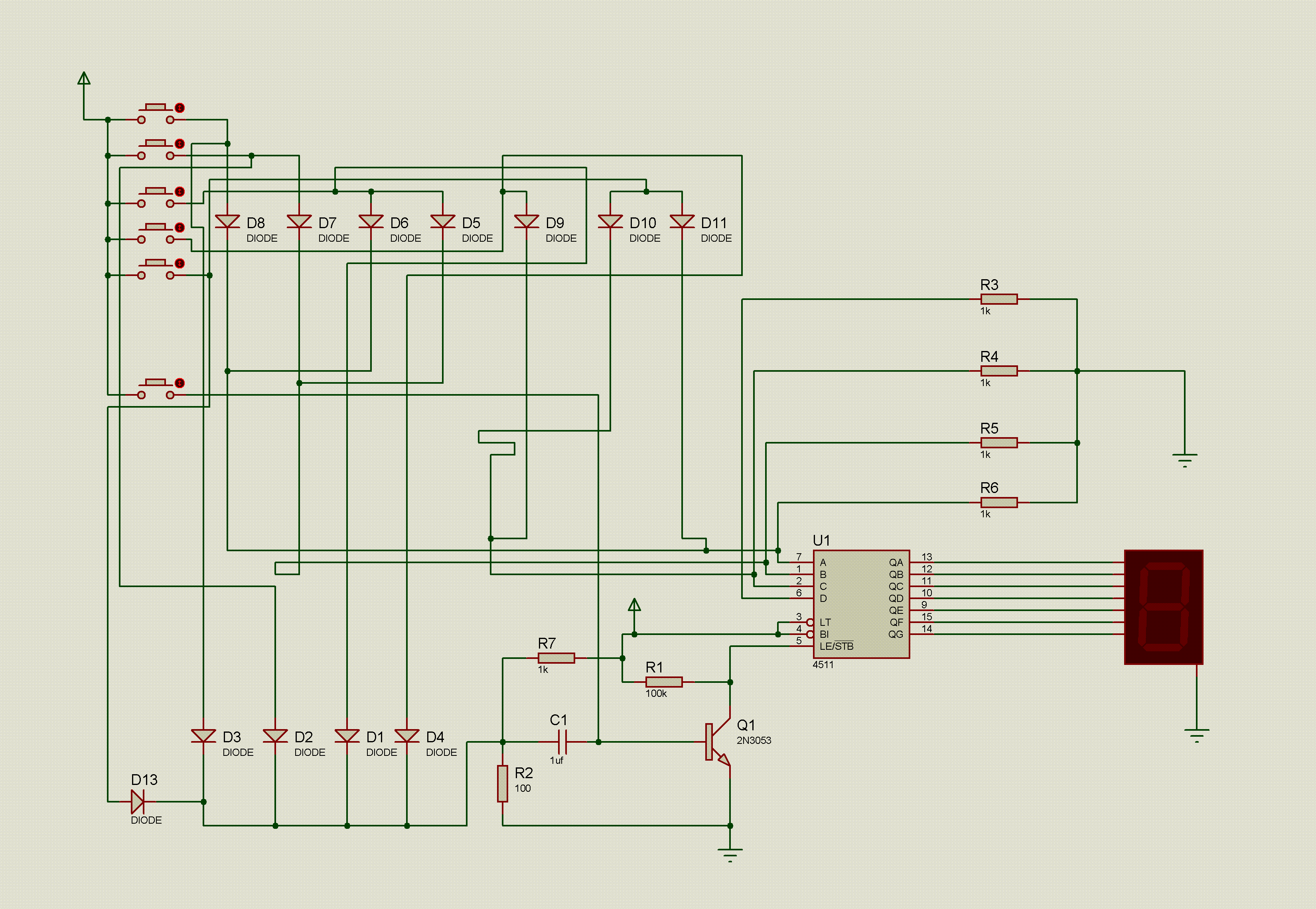

7-Seg LED + Enc , Dec and Latches

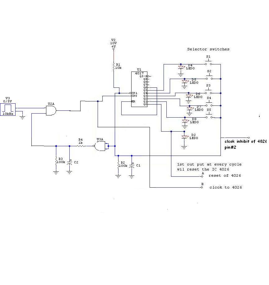

couter
here is ur counter .
you wil may have to play with some delay to synchronize both counters not to step out as shown in the diagram attached
