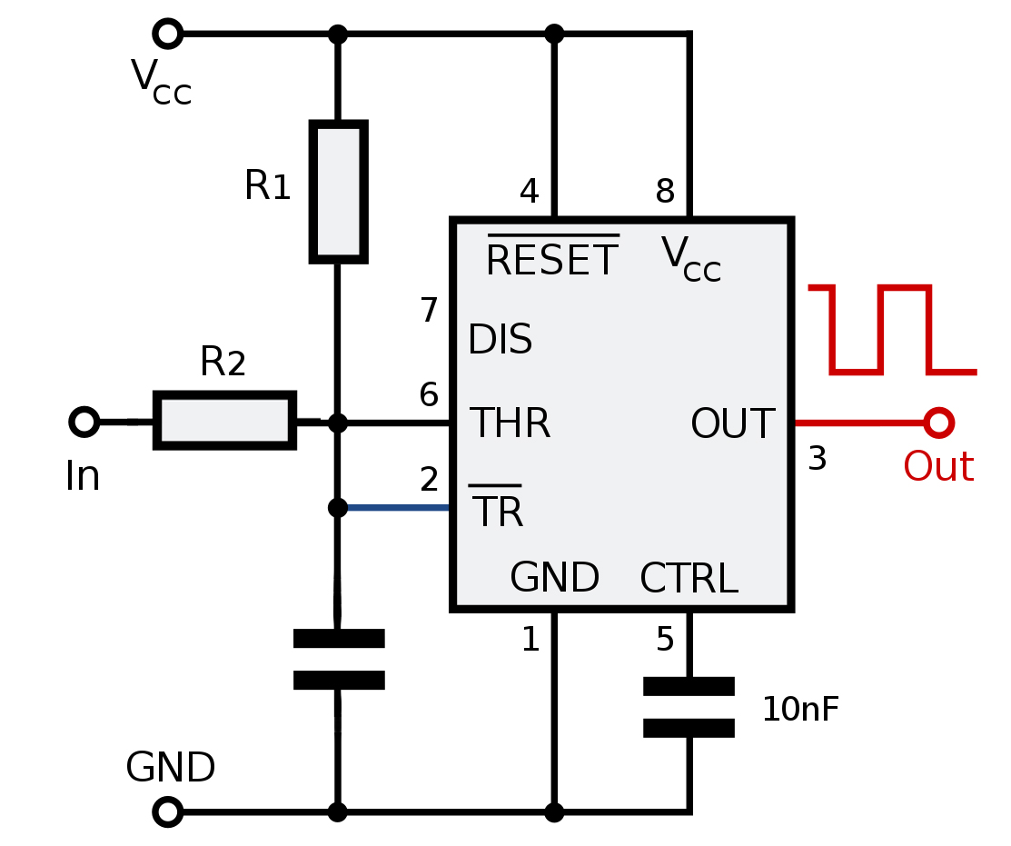

just noticed.. sorry but when you say swap the capacitor and r2, you mean the cap on the input or the one on the control line?
and as for the switch.. okay.. right now it's got power->switch->input line. but how does it work putting it going in->switch->ground?
Like this:
The input is normally pulled high by the resistors, the switch temporarily forces it low.
The times taken to charge and discharge the capacitor are controlled by the resistor values.
R2 must be a fraction of R1 to ensure the capacitor is discharged below the low voltage switching point of the 555.
(It's only needed to prevent excess current through the switch, as if a cap was directly shorted out).

anyway.. rebuilt the 555 schmitt circuit put the button, as told, between the In put and the ground but i think i got that bit wrong cause.. right, the button is a 4 pin.. so you need to attach it via diagonal. so... can't quite get the button inbetween two things like the in and ground.. tried a few little places but.. not sure.. i either got the button doing nothing, or jumping around..
kinda the last thing i tried was to put the button just on the input, so when pressed, the power goes to the button, then to the input, then through resistor 2 and on it's way.. but.. didn't do a thing..

Both Nigel and I have linked to the same article (I hadn't seen his link to it). Why the obsession with schmidt triggers when 2 resistors and a capacitor are all that's needed (and only 2 components more than the op's original debounce) and everybody's ignorning it?
Two resistors and a capacitor don't provide debouncing, as the article you (and I) linked to explains, it's the schmitt trigger than makes it work. I moved from the 40106 chip to a later PIC, and if you set the inputs as schmitt it debounces, set them to TTL and it doesn't. If you connect a storage (digital) scope you can clearly see what happens, and why it doesn't work.
