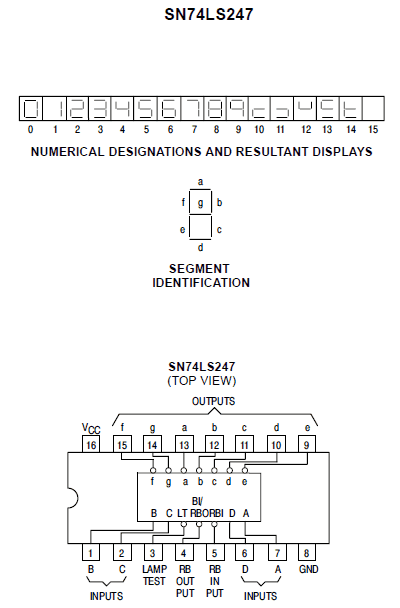

Check out the 74246, 74247, and 74248 or their LS (or other logic family) equivalents. They allow tails.

... with the 74247 allowing a tail on the "6", none on the "9".

Hello there,
That's interesting, where did you get that information? The Texas Ins. data sheet says that they are all the same with tails on both.
There's also the MC14513B (cmos) which has tails on both the 6 and 9.
The motorola data sheet I have for the 74LS247, 74LS248, & 74LS249 shows no tail for the 9 in their NUMERICAL DESIGNATIONS AND RESULTANT DISPLAYS graphic. However, their truth table contradicts this.

There appears to be a discrepancy between data sheets then so you would have to get one of each and test yourself or maybe find a website where someone did this already. Some of them might be hard to find anyway. Did you check out the MC part number yet? So you need it to latch too? Well, good luck with it.

I used the ON-Semiconductor (Motorola) data sheet of the SN74LS247 which shows no tail on the "9".
