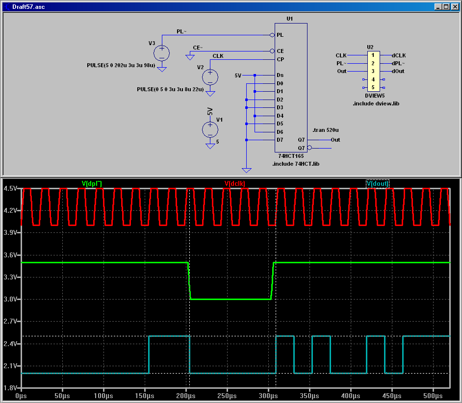

I rearranged the inputs to show which edge causes a change in the output.

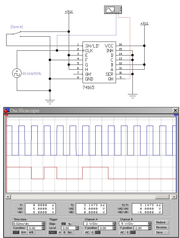

Below is my simulation in Electronic Workbench of your circuit, which works as expected.
But, in real life, this circuit could occasionally give an improper output if the load signal is not synchronized to the clock. If the clock and load signal happen to occur at just the right time, the circuit can enter a metastable state where the outputs could be incorrect. If that occasionally happening would be a problem in your application, then you need to synchronize the clock with the load signal using a flip-flop.
Thanks for the response, but it seems to work by putting a high freq clock at dclk pin. Why did the output pin decide to go HIGH prior to PL going LOW?
The only difference in the input pins from mine is that your connected the Ds pic to VCC instead of GND.
How would I synchronise the clk with a flip flop? The PL pin for my application is pulsed randomly. IF the clk was pulsed in the MHz region, then the PL pin will probably be in sync.
After 7 clocks, the +5V at Ds fills the shift reg with ones, causing Dout to go to One. It goes to Zero aysnchronously with the CLK when the falling edge of PL loads the Zero at D7. The next rising CLK after PL goes High shifts out D6.
