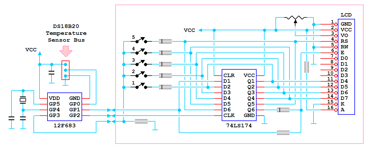

I'm trying to duplicate the functionality of your 16F88 / 74LS174 LCD demo' as much as possible using an 8 pin PIC as the host and I wonder if you think my method for driving and reading a switch matrix would work? (the swx label is defined as input gpio.3)
Mike
void lcd_buttons()              // read LCD switch matrix
{ char i;
  SwData = 0;                   // clear 'live' sw data var'
  data = 0;                     //
  for(i=0; i<6; i++)            // clock out six '0' bits
  { clock = 1; clock = 0;       // to clear the '174
  data = 1;                     //
  clock = 1; clock = 0;         // col 0, '00001' (Q5..Q1)
  data = 0;                     //
  if(swx == 1)                  //
    SwData |= 0b00000001;       //
  clock = 1; clock = 0;         // col 1, '00010'
  if(swx == 1)                  //
    SwData |= 0b00000010;       //
  clock = 1; clock = 0;         // col 2, '00100'
  if(swx == 1)                  //
    SwData |= 0b00000100;       //
  clock = 1; clock = 0;         // col 3, '01000'
  if(swx == 1)                  //
    SwData |= 0b00001000;       //
  clock = 1; clock = 0;         // col 4, '10000'
  if(swx == 1)                  //
    SwData |= 0b00010000;       //

If you liked that, you're going to really like my new **broken link removed**. :D I'm at day 2 and have the LCD working, but nothing else yet.
That's a cool idea! Have you tested it yet? I'd have to spend some time thinking about it before I could say whether I think it'll work. But I've been busy cutting, stripping, counting pins, soldering...
It looks very nice and so does that prototype board with SOIC part spacing.
No I haven't tested it yet. I don't have a 74LS174 or a 74HC164 in my parts inventory so I'm just experimenting with BoostC code at this point.
