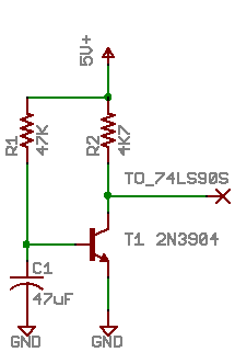

Hi all,
OK, hopefully this is the last question I'll need answered on my TTL foosball scoring circuit. Thanks to those who've helped so far!
Last thing to do is to have it reset to 0 automatically when first powered on. I *also* need it to have a manual reset switch.
For various reasons (mostly room, actually--and I want to get this thing done tonight if I can, for another), I don't want to go with an IC-based Schmitt trigger, which I've read here is the preferred solution. I've tried a couple of basic RC nets on the reset pins but can't get the thing to count with it attached (i.e. it keeps the reset pins off ground). I tried sticking a 2n3904's emitter to ground, collector to the reset pins, and base to a RC net designed to delay the base input by ~20mS. This configuration let me count but wouldn't reset the circuit on power-on.
Seems like there *must* be a way to do this, given the number of references to doing it with only an RC net I've found. But I'm just a hobbyist with no calculus and a very, very basic understanding of what's actually going on in the RC net, so I am not sure what I need to change to get it working.
I'm going about it fairly emperically right now (just researching/googling, trying different things, failing, reading more, trying again....) but I'm hoping somebody has a) the answer and b) the urge to write up a quick answer/explanation/pointer to solid information on this. Seems like a pretty basic thing, but I just haven't learned it yet.
If the reset pins on the LS90 were active LOW, this would be true but they are active high. I think your transistor method will work if you use a bigger cap. I assume you have something like this:
I do indeed have something like that, except I missed a resistor. And my cap value was way lower. :) This does the trick.
I do have a couple more problems but I want to keep working them before asking about it.
Thanks a lot for the help!

I've had a quick glance at the datasheet and MR1 and MR2 both need to be high to reset the counter so connect them both to +V via a 1nF capacitor and to 0V via a 100k resistor.

It is power-hungry TTL (LS-TTL). Each input sources a max current of 0.4mA and you want the low voltage to be 0.4V so a resistor to ground for each input should be only 0.4V/0.4mA= 1k ohms max.Then use a huge reset capacitor.

Thanks! And it appears that the main problem I was still having was just related to the score and win triggers (more 2n3904s), which seem to have been pulsing the power supply enough to trigger the power-on reset circuit...but only when the lines meant to run to the indicator lamps were attached. Meaning that if you scored, the thing would instantly reset unless you had the lamps unplugged. Not nice.
Bypass caps on the score and win circuits seems to have taken care of it, though. I'm still poking around to try to figure out if I can explain the exact mechanism of the problem, but at least it's solved--although I don't trust any solution I cannot explain :).

The power on reset circuit is very crude. I suspect the reason it was triggered spasmodically is due to the electroylic cap. These have a relatively high ESR and high impedence at high frequencies.
I would have used a Schmitt Trigger, eg. a 74LS14. Connect a resistor and a capacitor (say 100 nF) to the input. The top end of the res goes to +5 Volt and the lower end of the cap goes to gnd.
There would need to be a second one to invert the signal if you want an active low reset signal.

TTL eats power. Even LS TTL. So a 0.1uF ceramic disc capacitor is a must across the power pins of each IC to stop the circuit from behaving erratically.
Make the 0V wire pretty big on the circuit board.

You may be able to use one of the input debouncers or timers for the power on reset (if there is a spare section in an IC, eg. one Schmitt spare in a Hex Schmitt or if you are using a 555, use a 556 and use the spare section for the POR.
Torben said:
I'm not sure if you're saying to connect the Schmitt trigger and then use the RC net you describe, or to just use the net right on the 74LS90 reset pins.
You could connect it directly to the 74LS90 reset pins if you wish, I prefer the Schmitt solution as it gives a "clean" pulse to the 74LS90 reset.
