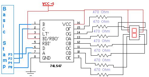

Hello Everyone,
I'm trying to run this code with my BS2, I don't understand what I'm doindg wrong,
counter var nib
OUTA=$0
DIRA=$F
loop:
FOR counter=0 to 9
OUTA=counter
pause 1000
NEXT
goto loop
With this program I suppost to counted between 0 and 9.
PLease if any body can help me I will be glad.
Thanks.
This is my schematic
I know LED's come in 2 variants:
COMMON ANODE as well as COMMON CATHODE.
The way I see It, you have wired up the circuit as if you will be using a COMMON ANODE LED, if however the actual LED you are using is COMMON CATHODE, then you will experience problems.

i agree .. sandoval , what is the number on the LED.?
