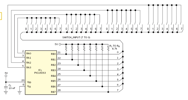

i have a pic microcontroller and i configured the port-d as input . port-d is 8-
bit, so in this case i have 8-inputs with values from 1 to 255 ,and if i connect
bit0 and bit1 to vcc i get this decimal value "3" and if i connect 4*4 keypad
so i have 16-inputs with corresponding value ,but in this case i cant press 2
buttons or 3 at the same time , now how can i get 16 inputs from 8-inputs
and can press or enter 2 inputs in the same time and get 2 values for it ?
is that possible ? am thinking for 2 days and i cant get it .
regards .

first thanks for reply ,
but i think you miss understand somthing . to be come more understandable
and reliable . think about this 4*4 keypad as 16 "DIP SWITCH" and if you turn
on switch no.1 then you will recive "xx" value . but what if i turned on switch
no.1 , no.2 ,no.3,no.4?
in this case what will be the result ?
understand what i mean , thanks .
regards

in other words , i need to get 16 inputs from 8 input , and every bit in this input have a unique value , so i can enter 2 or 3 input at time . and get its values .

ronsimpson said:
A key matrix is not intended to work with more than one switch closed.
Actually, you can decode multiple concurrent key presses on a multiplexed 4x4 keypad quite easily... Unfortunately it may not do what the OP would like because it's difficult to press more than one key at exactly the same time and if the keys are located in different scanned columns (or rows) they might be detected at different times (during a different scan period) unless the keypad code scans all four columns (or rows) sequentially before returning with key press bit results...

Amenoera,
I think your “page 3” example will not work.
The switches are “DIP Switches” so many may be closed. These are not key but switches.
Example:
Close switch A0 through 7 and switch B3 all other are open
RA3,2,1,0 = 1111b RB7,6,5,4,3,2,1,0, = 11111111
Scan switches
RA3,2,1,0 = 1110b RB7,6,5,4,3,2,1,0, = 00000000
RA3,2,1,0 = 1101b RB7,6,5,4,3,2,1,0, = 00000000
RA3,2,1,0 = 1011b RB7,6,5,4,3,2,1,0, = 11111111
RA3,2,1,0 = 0111b RB7,6,5,4,3,2,1,0, = 11111111
Problem: When switch A 0 through 7 are closed it shorts RB7,6,5,4,3,2,1,0 together.
This is why I suggested adding diodes. Diodes work, I have done this. See old message.
