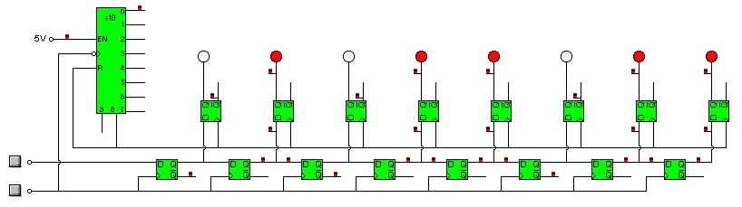

Hey,
I might be being stupid or something, but is there one chip or a few chips that would emulate the circuit in the attachment?
Basically its some sort of shift register setup I'm looking for, using only two output ports so that I can use one for data and one for clock and once I've clocked 8 bits of data it latches it to the real outputs? I was looking at some 4000 series datasheets but nothing obvious. Would be stupid to be using that many D-type chips.

Hmm quite a large chip and can't seem to find it in stock at Rapid. Is there anything more easily available? I don't mind two chips if absolutely necessary. I might be able to do away with the counter and scrounge an extra clock pin off the microcontroller if necessary.
74HC595 from TI and others is what you want. The HC part may have several cousins in othe logic families that will be of interest.
If you need to drive some heavy loads you might want to look at Micrel MIC5821 or MIC5841 serial-to-parallel 8-bit sinking drivers... They also have a cascadable 3-pin interface (Data-In, Clock, Strobe, and Data-Out) and can sink several hundred milliamps... The Allegro A6821 and A6841 are similar devices...

A CD4094B will do the shift and store. It will not sink or source very much current. This whole series of chips is kind of obsolete now and the number of suppliers is diminishing. Something to keep in mind if you plan to build any quantity.
there are two chips you can use to do exactly the same thing. You need a shift register (74HCT164 for example), and you need a counter with an enable pin. A cmos 4017 counter will do the trick.

Anyway I think I will go the 4094 route, even if they're apparently dying I'm sure I'll be able to get hold of some for a time to come.
Would a transistor array such as the ULN2803 be suitable to connect to the outputs of the latches and then drive small relays or some LEDs or something?
Also, cascading 4094s is done just by connecting data out on the first chip to data in on the next one, and so forth, and then connecting clock and strobes all to two common microcontroller outputs so they are all strobed or clocked together?
