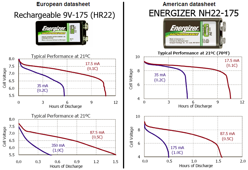

HR22 is 8.4V nominal and drops to 5.5V after 30 minutes @ 350ma drive current (1C).
where did you find the European datasheet for Energizer's 9v Ni-mH battery?
I didn't know it is made in Germany. Their Ni-MH single cells are made in Japan.
There are differences in the European and American datasheets for the 9V battery:
1) The voltage of the European one drops much more and quicker when the current is 17.5mA, 35mA and 87.5mA.
2) The European voltage curve at 350mA looks wrong.
The datasheets look different because the European one shows the older 7.2V/150mAh (6 cells) Ni-mH battery while the American one shows the newer 8.4V/175mah (7 cells) one.
