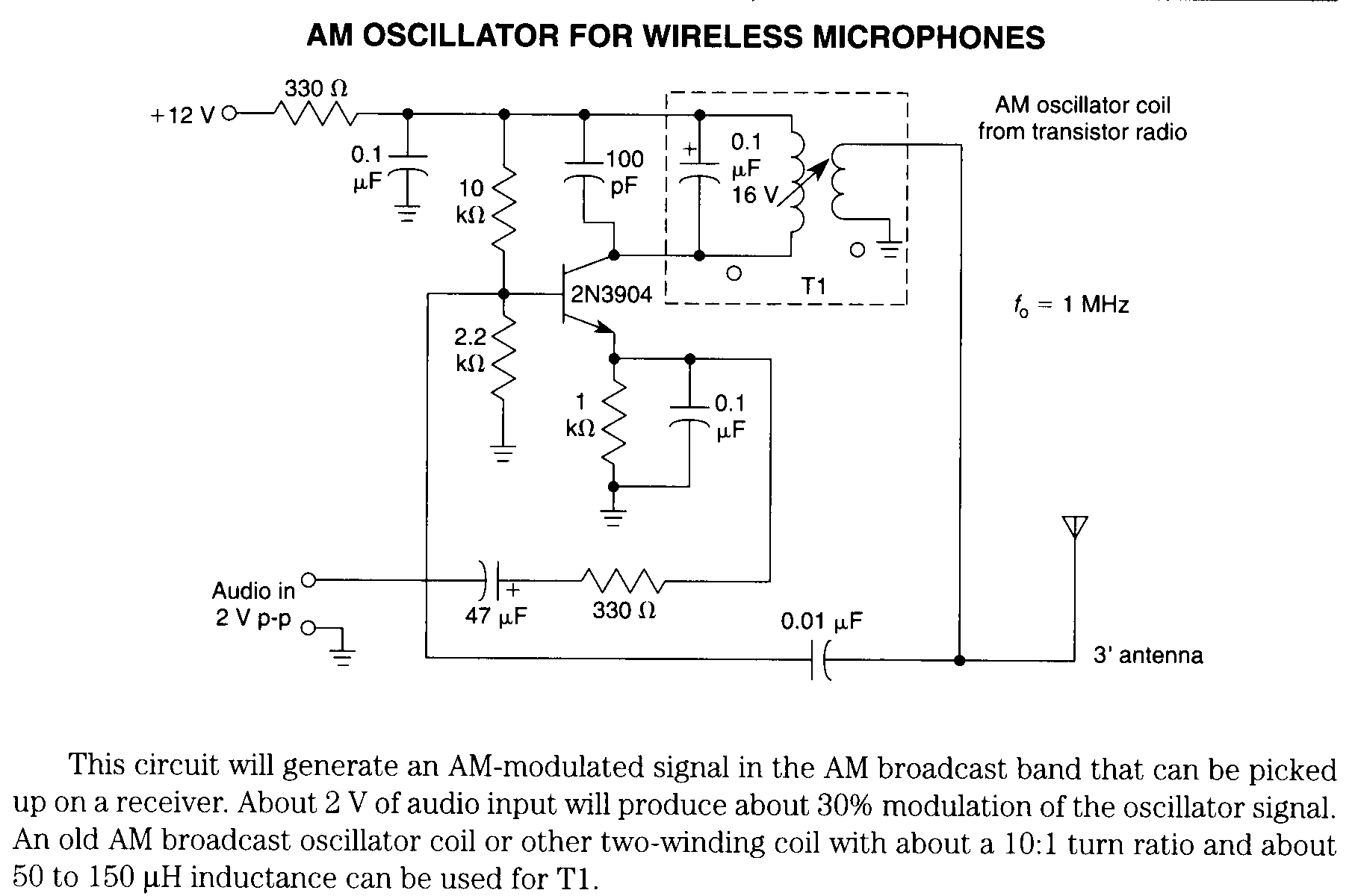

I need a AM radio transmitter circut.
I want it simple (litle of parts and basic parts)
I want it for a carbon microfone (i don't have other tipes)

I recall the term "phono-oscillator" being used to describe a simple AM transmitter. You might find what you need by searching under that term. While it seems that a carbon microphone can be adapted easily the old designs might be more amenable to the mic. Some of the "phono-oscillators" were vacuum tube, some solid state.
Here it is!

But i have the shematics! 8)
PS:
I re drawd the shematics(with Crocodile Tehnology(a great simulator))

Nice isnt it!
Its realy simple!
Tips:
If you get your hends on some powerful transistors try with 9V
Buld a vertical antena for beter performance!
If it dosent run on a batery use a capacitator(big) to get rid of that 50Hz "Hum"
A batrery can run i for a wery long time(curent 2-6 mA)!!! 8) 8) 8)
