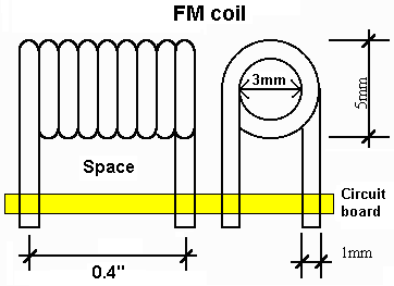

I've been looking into building an FM transmitter recently and discovered audioguru's Mod4 circuit. It seems to be one of the best on the internet (I've searched through a lot)! I will be using the stereo input addition, and I am wondering what kind of wire I must use for the coils. I know enameled copper wire is usually used but I can't seem to find where to purchase it or get it from another device. I also read that normal #24 AWG hookup wire can be used. Is this true? And if so, will performance be affected if I use it? Finally, is it okay if I power the whole circuit from 5 volts (including the last part). I am guessing that the output range will simply be less.
Thanks!
I used 1mm enamelled copper wire from the crossover coil of a speaker to make my coils. They look like this:
If you use different size wire then the tuned frequency range will be different.
I never tried my FM transmitter circuit powered from 5V. Its range will be reduced.
24AWG won't be mechanically stable like 1mm wire. Its frequency will change with the slightest vibration. Electrically, it will work just fine.
