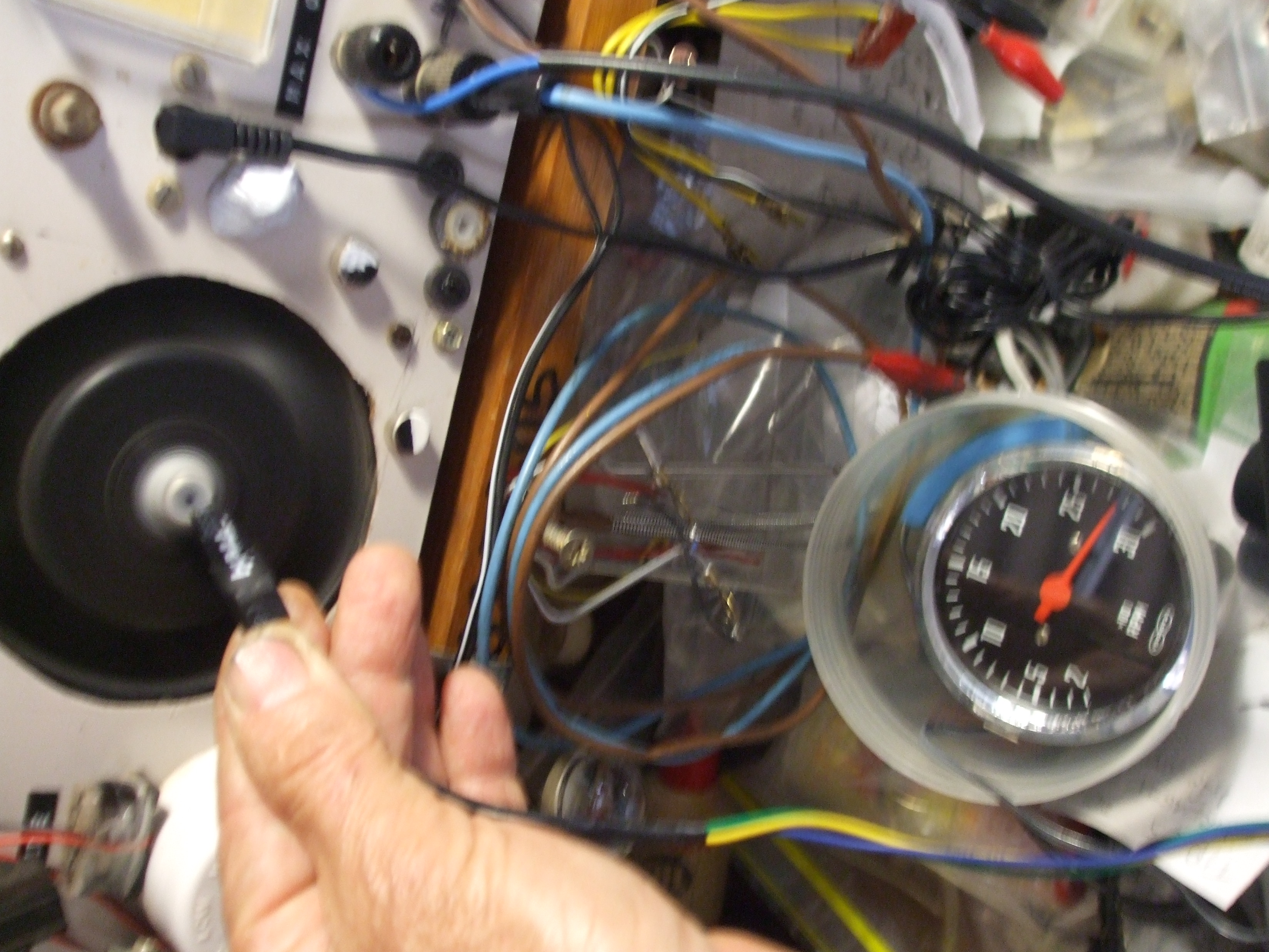

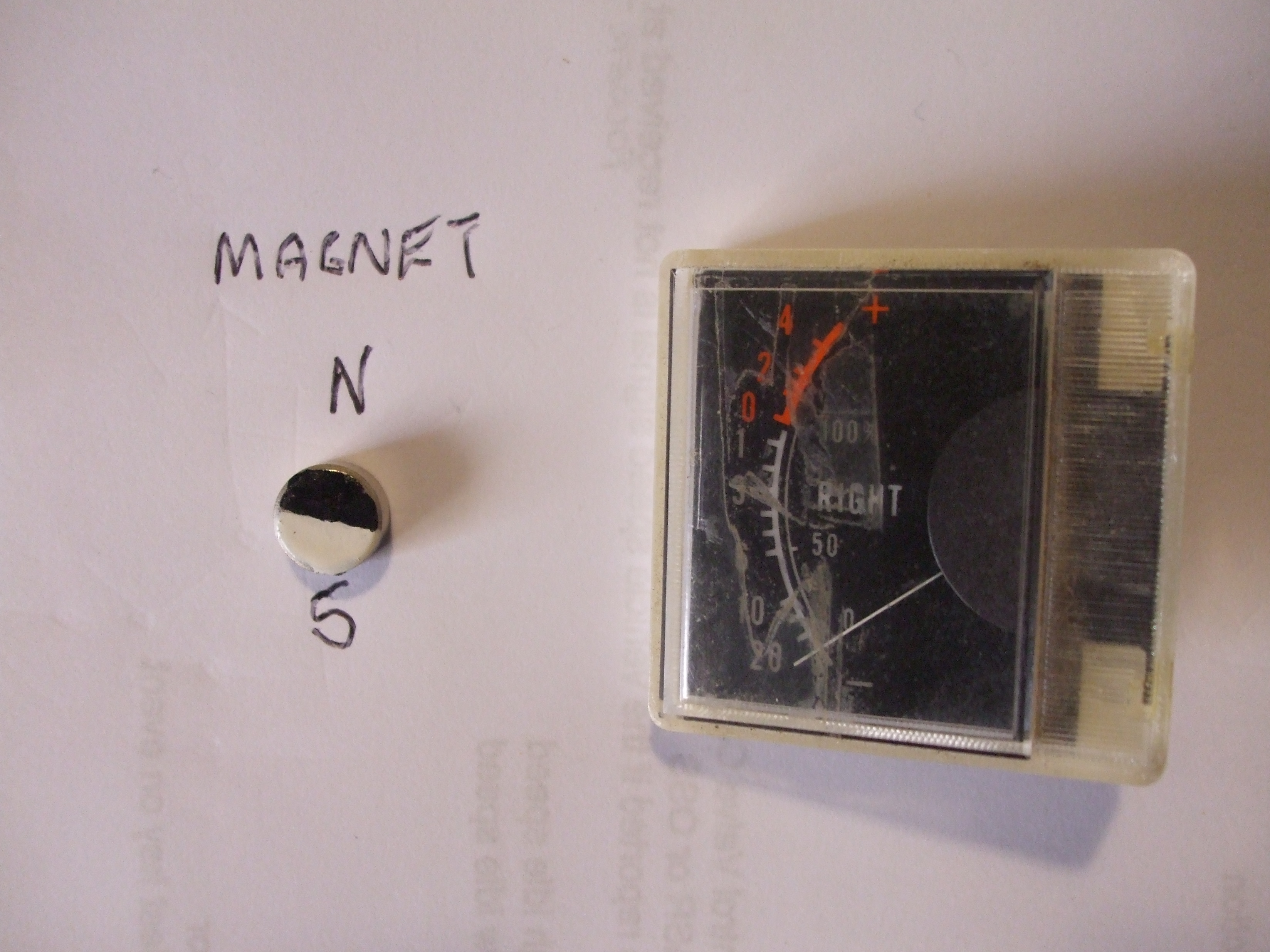

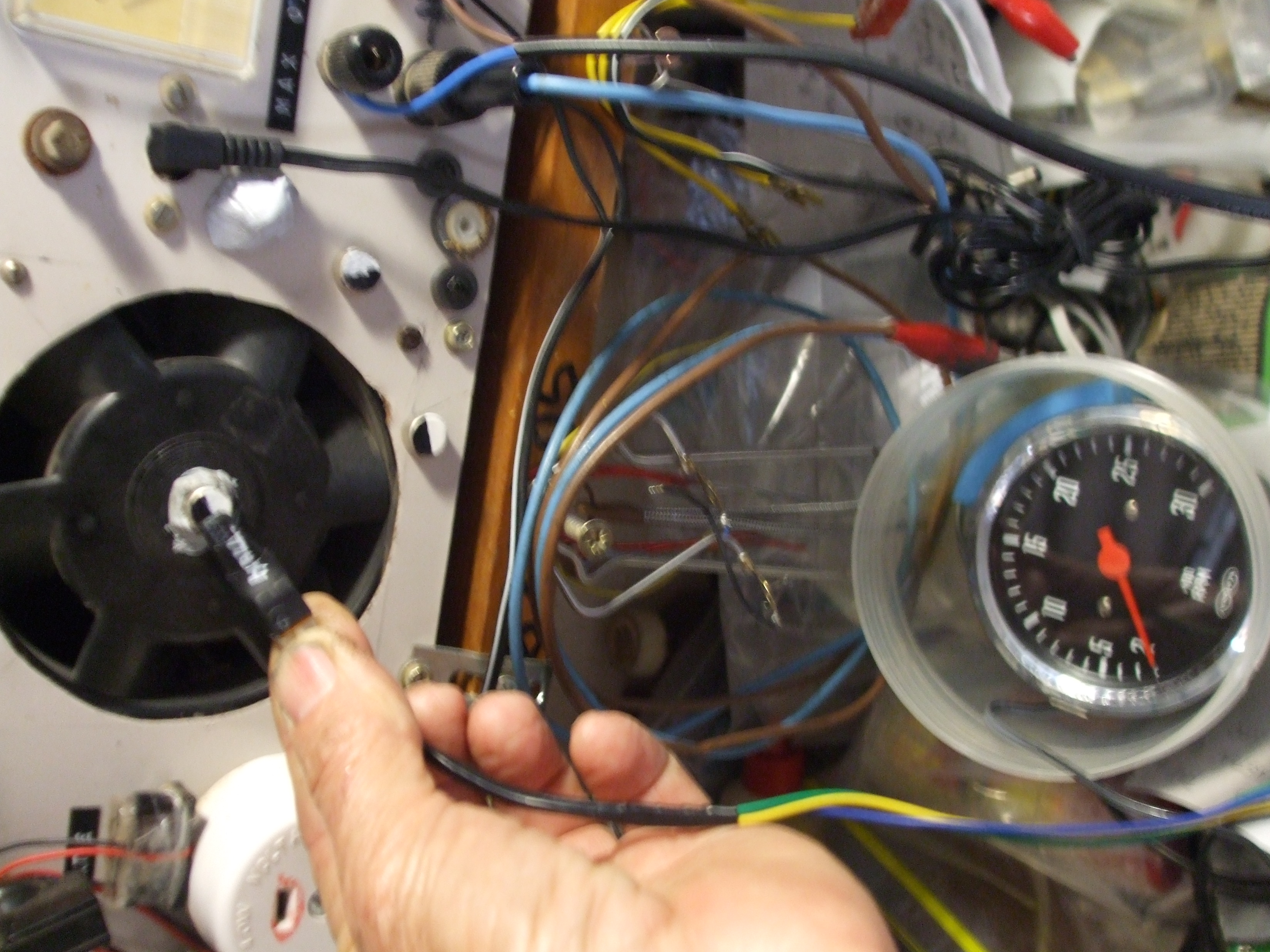

To drive the hall i used a small magnet out of a scraped signal level meter, If its glued to the engine shaft as in picture it will give a Nth then a Sth pole presented to the hall switch. The hall requires this to turn it on then off. Using one magnet it is easy to calibrate as in my early pictures using a small solenoid to drive the hall. Here the mains is 50Hz & gives a reading of 3000Rpm
This is the data sheet for your series of sensors. Something to note here is where the data sheet shows "South Pole-sensitive Switch or Bipolar Latch Available ". The sensor bebe used was a bi polar latch and thus he uses both poles. The N pole latches and the S pole unlatches to create his pulse. This would be the same as the MP101303 in the data sheet. If you use the MP101301 or MP101302 you only need the sensor to see the S pole and each time the S pole passes a pulse is generated.
Ron
