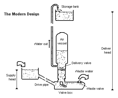

Ram pumps are water pumping devices that are powered by falling water. The pump works by using the energy of a large amount of water falling a small height to lift a small amount of that water to a much greater height. In this way, water from a spring or stream in a valley can be pumped to a village or irrigation scheme on the hillside. Where ever a fall of water can be obtained, the ram pump can be used as a comparatively cheap, simple and reliable means of raising water to considerable heights
However..
You can see that the one big disadvantage of a ram pump
is that it wastes a lot of water. Typically about 10% of the
water it consumes actually makes it up the delivery pipe.
The rest flows out of the pump as the water builds momentum.
Flow is everthing, and in this case we have none. The water source
is from a borehole. So no free lunch pumping anything up hill :lol:
This is an ideal pump when a plentiful water source is available, it also
makes an the use of high speed turbine posibble in situations that would
normally require a large water wheel and associated gearbox.
