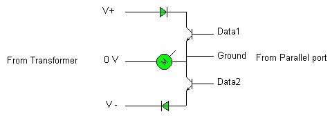

A simple qestion. Plese...
This is now certanly working!
I call it the E-bridge
The difrance betwen the old(un working)Circuit is that the botom transistor is flipt verticaly
What do you think? 8)
It won't work. Sebi's circuit is a good one, but if I understand you correctly, you don't have any optoisolators or a PNP transistor.
The bottom line is, you can't make a motor reverse directions with just 2 NPNs controlled from a parallel port.
Well the motor was thurning in bouth directions and with just 1 mA as input
Did you see this on your simulator, or do you have hardware running (i.e., a real motor)?
