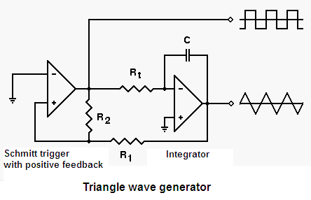

Ok guys thanks for all the help I'll use a dual op amp setup ag audioguru suggersted, one op amp to generate a square wave, the other as an integrator
it will be like this
triangle-wave-gen-png.9012
trying to build this

trying to make a triangle wave.
this schematic looks nice, though I am not sure what pins to use or which parts are represent.
any help available?

right, but as my original post in this thread stated, I am not sure which pins this schematic is referring to on the chip.
I am assuming the - represents pin 2 and the + pin 3? what pin is represented by the output? what type of caps and resistors hould I be using?

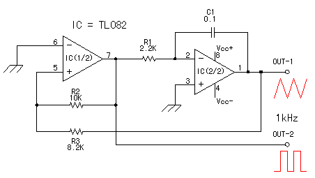

Look in Google for Triange Wave Generator Circuit and you will find links that explain all about it.
Look at the datasheet for the uA741 or LM741 and the pins will be explained.
okay, I hooked it up and nothing is happening, I am getting some sort of sound, a harsh fuzz. doesn't sound like a triangle wave. I still found no advice on what capacitance and resistance to use. what does Rt as opposed to R1 and R2 represent?
An opamp cannot drive a speaker. The oscillator can drive an LM386 power amp that can drive a speaker.
The oscillator cirrcuit uses a dual polarity supply.
The first link in Google has the details of the circuit: https://hobby_elec.piclist.com/e_ckt16.htm It uses a dual opamp so its pin numbers are different than the single 741 opamps.

I built according to the non labeled schematic in this thread using two 741s with the + and - pins corresponding to the 741 data sheet.
