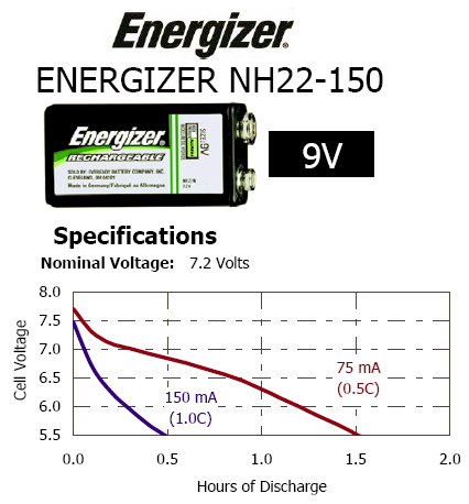

Energizer's "9V" Ni-MH battery has six 1.2V AAAA cells for 7.2V. Its capacity is next to nothing.

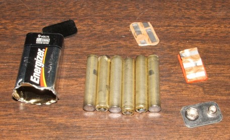

Wow, I never knew thats how the 9v worked. I just tried it with an Energizer. Mine lacks that foil tape that is connecting the ends in the Duracell though.
