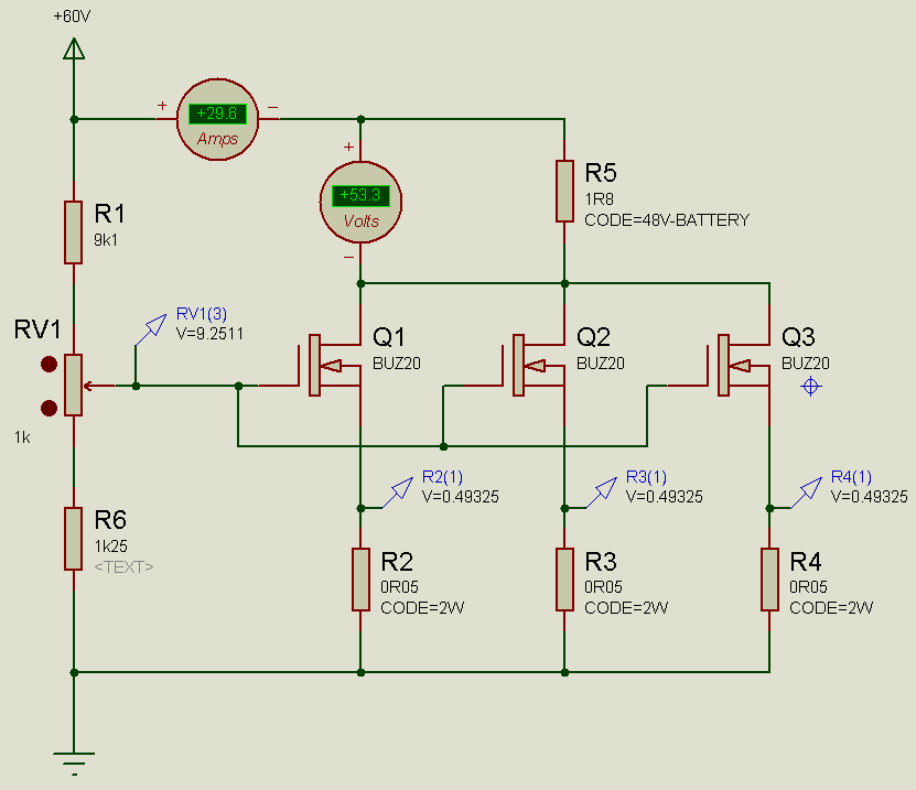

So how can i manage to get 60V or a minimum of 55V at the out put ??? Can LM338k withstand with a maximum of 60V or 65V at the input to get 55V or 60V at the out put????
I think input to these regulators should not exceed 40V. am i right? i yes the how can i get 60V at the ouput? is there any regulator IC that can regulate that much voltages? what about The IC LM2576HVT-ADJ ?

I suggest you consider a solution using several paralleled power MosFet transistors and adjust the gate voltage for a maximum of 52.8V to float charge the battery to that absolut maximum voltage at your desired maximum charging current.
Here is an example to get the circuit to work within limits of components. The BUZ20 can stand 100V at 12V. R2 ... R4 take care of equal source voltages. When building the circuit make sure source voltages are pretty much the same on each transistor for equal current distribution.
If the pot is turned all the way down (to ground) the circuit might also be used to charge 24V batteries.

Thank u very much sir, but i took it as a project and i have to build that supply/charger. i will try to build a switch mode powersupply/Charger.... will it be better??

--->About LM338K is that they can be managed (Connected in parallel) to handle about 30A of current. since each LM338k gaurenty 5A Current delivery so to get 30A current at the output to charge 300AH or down to 200AH lead acid batteries can be designed.... since large heatsinks and cooling fans will be required in the housing.
--->From the above description a power of 1800w will be managed.
--->is there LM338K HV version IC available? that will be pretty enough for me to get my required regulated out put. :)
