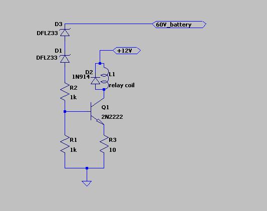

modify colin's circuit for a 60V battery as shown below. the charging voltage of a 60V battery is 66-69V. the circuit will pull the relay in when the battery voltage goes above 67V. it needs a separate 12V supply for the relay. if you're actually charging at 30A, then the relay needs to be a 60A rated contactor, the snubber diode will be a 1N4004 instead of a 1N914, and the transistor will be a 2N3055.
Do you suggest to charge the battery or boil it?
A 48V battery is fully charged at 52.8V! Everything above that voltage will cause the battery to gas freely. After that "BOOM".
