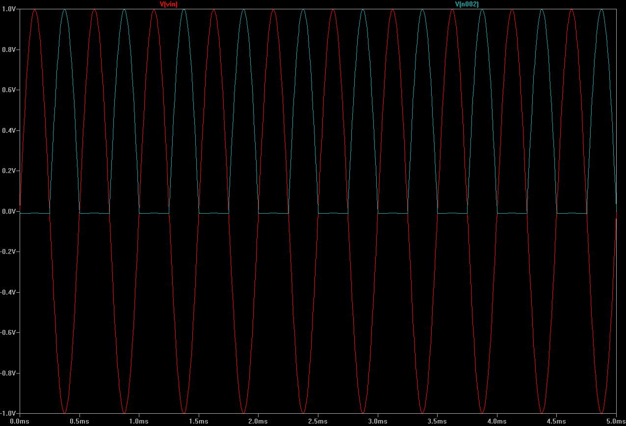

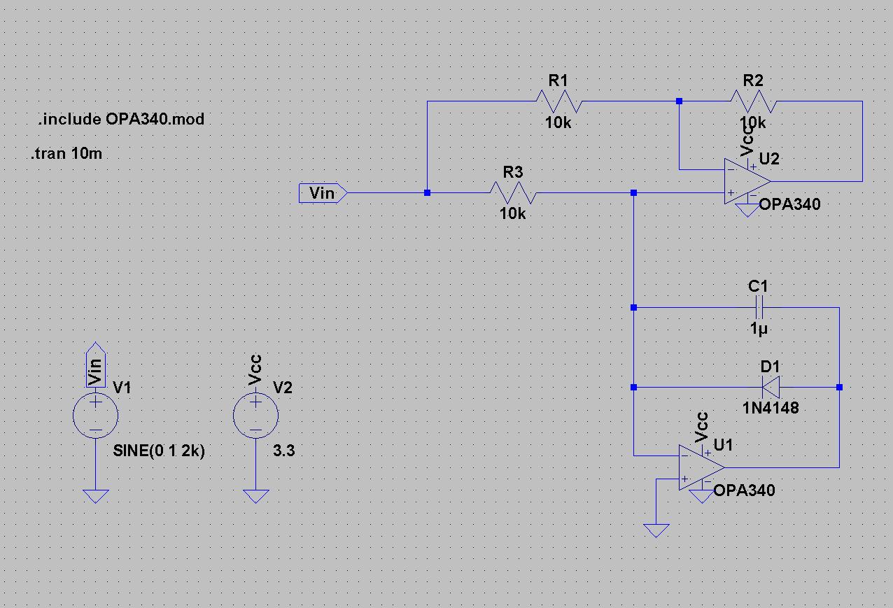

I'm trying to design an absolute value circuit with single supplied opamps. I have read the SBOA068 Application note from TI (available online) and tried to simulate the circuit attached below in LTSpice. This circuit is proposed in the app note from TI in figure 5. Unfortunately, by observing the output waveform (where V(n002) is the output voltage) I presume that some error exists, either in the schematic or my design. As you can see, the output is zero when Vin is positive and an inverted version of Vin, when Vin is negative.
Reading the analysis at the SBOA068 app note it says the following :
1) When Vin < 0, then D1 is forward biased and holds the non-inverting input of U2 at virtual ground. Thus U2 operates as an inverting unity gain amplifier.
(So far, so good. My output follows exactly this description.)
2) When Vin > 0, then D1 is reverse biased and thus has no influence on the circuit. And U2, R1, R2, R3 operate as a voltage follower.
Well, this is not true to me. If D1 is removed from the circuit, I cannot see any voltage follower. The non-inverting input of U2 is again tied to ground and U2 operates again as inverting amplifier. The difference is that the output cannot go negative (due to the single supply operation) and thus the output is zero.
Does anyone know where the error in the schematic is? Or maybe in my thoughts above.

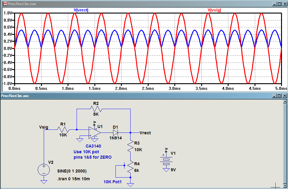

hi nick,
I have downloaded the app from TI, will you please post the ltspice.asc file so I can check thru it.
This circuit image is the one I use for some projects, it works OK in LTS.

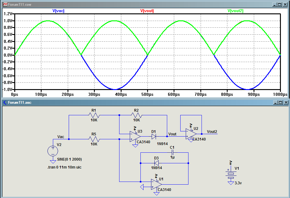

hi nick,
Look at this LTS image, added a 1N914 diode in the top OPA.

Dear ericgibbs,
please find attached the .asc file that I use...
I have also just seen your latest post, so I will try to use the additional diode that you propose and come back.

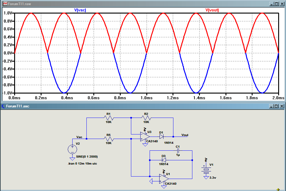

Hi ericgibbs again!
Your suggestion to add this diode at the output of the upper OpAmp was really helpful! Indeed, the circuit is now operating as intended, a full wave rectifier!

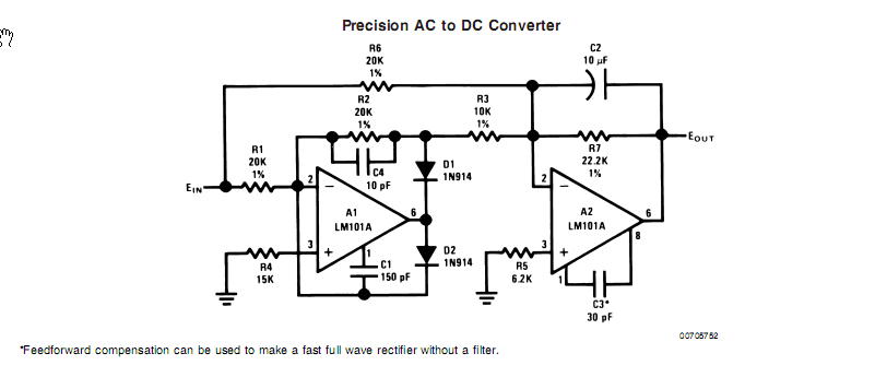

Could you please give me additional information? Which of the two circuits is best, according to your opinion? I'm talking between the one published on the app note of TI and the other one that you proposed (with the LM101A), which I assume is from the datasheet of the LM101A.
Thank you very much for your help! You contribution was really important to me!

This is a very basic absolute precision rectifier.
Note: the Vpk out = Vpk in/2
Yes, I have also considered using this circuit (with also adding an input and an output buffer). But the fact that the pp voltage at the output is half the input voltage, is something that I do not want.
hi nick,
Your circuit requires a high impedance buffer OPA on the rectified output else the symmetry of the halfwave rectified will be degraded.
hi nick,

The buffer is shown in my last posted image.
I would add any filtering onto the output of the buffer, keep the full wave rectified signal isolated from any capacitor.
BTW: the CA3140 also comes a dual CA3240 for about 0.5Euro.
