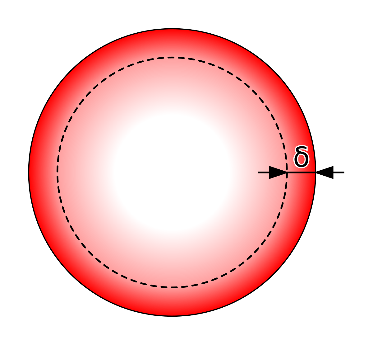

Not really an issue at 50/60Hz, as made clear in the page you linked to - where it states skin effect is 8.5mm at 60Hz - if a bulb filament is thicker than 17mm I think we've got problemsWeb reference -
Then there is skin effect -
Skin effect - Wikipedia
en.wikipedia.org
And effects due to thermal mass in AC environment.
Regards, Dana.
Not really an issue at 50/60Hz, as made clear in the page you linked to - where it states skin effect is 8.5mm at 60Hz - if a bulb filament is thicker than 17mm I think we've got problems![]()
Inconsequential for anything inside a light bulbOf course that would depend on length of run from power source to filament. But
like neutrino concentration in the Copper I agree maybe inconsequential. For short
to moderate runs.
Regards, Dana.

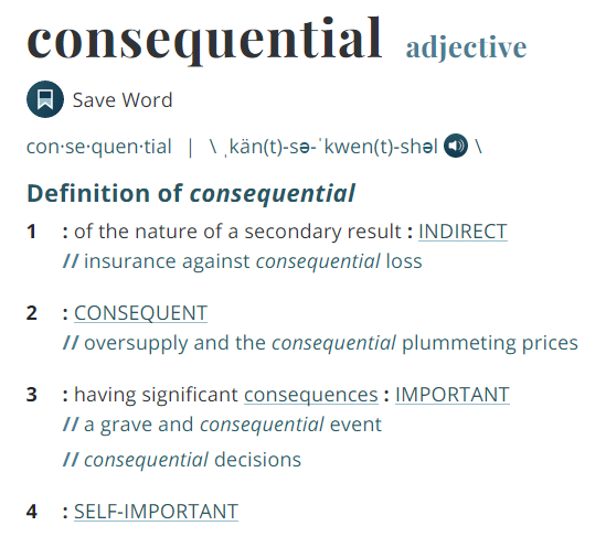

I suppose if you were running a cable to the moon it might be 'consequential'Consequential for long runs though
A factor under certain circumstances. Secondary effects become important
at extremes.
No, physical facts....But is it something you've just 'made up' anyway?
