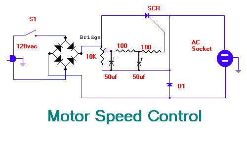

Hello All:
Is it possible to modify this circuit to incorporate a thermistor, so the speed of a AC motor can be controlled by temperature. At room temperature I would like the motor to spin at around 30-40% of it's rated speed. As the temp increases by 20 degrees or so the fan should increase to about 80% of it's rated speed.

Whay this circuit needs DC power through SCR, is it possible to change thi circut using only AC power without diodes(rectifier bridge)
And what shoul I change to use thiscircuit on 220 V
In this case the bridge output not contain a condenser, so the SCR can commutate.This is a primitive full-wawe splitter, but not working properly with AC motors.
Quite true, it's a simple speed controller for AC/DC motors (not AC ones), probably designed as a drill controller.

You need to specify what type of motor it is, some AC motors can only be controlled by altering the mains frequency.
It is simole AC 220 V motor( i dont know name in English) but this kind of morors are used in drills, mixers, and home appliances.
I need a motor speed reducer, that can also be used for light dimming.
