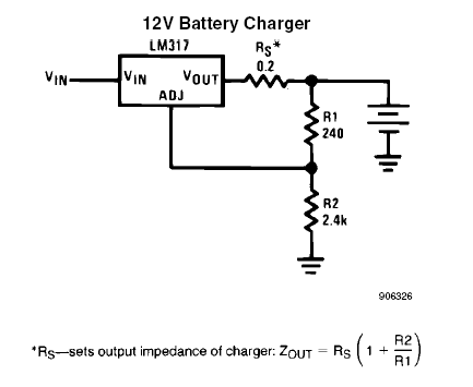

Look Babzok, here is the circuit you need
At the left, you can see the transformer, it says 28V but ignore that. Then, the diodes in diamond shape, that's called a bridge rectifier, it converts AC into DC. The LM317 its a voltage regulator, you should select the desired output voltage (22V) turning the pot shown in the circuit (4k7)
Anyway, I don't understand why do you need 22 VDC, didn't you said that the ugly unit used DC, and the cool one used AC?
edit: I remember the LM17 needs an input voltage >=3 volts superior to the output, so I'm afraid this thing may not work.
2nd IDEA:
Why you don't try to open the transformer? Inside the box you'll find the transformer, and a regulator circuit. We can modify that circuit to give the desired 22VDC
Swap the 240R for a 91R, the LM317 requires <120R to work properly, use 240R is for the more expensive LM117.
Swap the 4k7 pot for a 1k5 fixed resistor for 22V.
For only 15mA of output current the huge 2200µF capacitor can be reduced to just 33µF assuming the minimum transformer voltage is 24V.
Where did you get this from?
All the datasheets I'm looking at (LM317L, LM317HV, LM117/317 from NSC) all give the same examples with 240R, and don't differentiate anywhere between the 117 and 317 for R1 that I can find. Many of their application examples use 240R for both the 117 and 317. In some of the examples they use 120R, but again, with either part. I've always used 240R and they've always worked flawlessly....
Care to shed any light on your information? :)
I got this from the datasheet.
The circuit on the datasheet is for the more expensive LM117 which is clearly labled on the schematic.
Refer to the minimum load in the electrical characteristics section of the datasheet, page 4 for the LM117 and page 5 for the LM317. The LM117 has a maximum minimum load current of 5mA and the LM317 has a maximum minimum load current of 10mA. If the load is under the maximum minimum load current then the regulator won't regulate properly under light loads and will probably output a higher voltage than it should.
R1 sets the minimum load current, the minimum referance voltage is 1.2V, therefore the minimum load current = 1.2/R1.
1.2/120 = 10mA
1.2/240 = 5mA
This means that for the LM317 R1 should be <120R and for the LM317 R1 should be <240R. I chose 91R for R1 in this instance for convenience's case as it means that for an output of 22V, R2 = 1k5 which is a standard E24 value.
I generally keep R1 above 91R in all of my LM317 designs because it keeps the quiescent current down.
In some instances I might choose a higher value than 120R for R1 (not too high though as Iadj starts to take effect) but that's because I know the circuit connected to it will always draw >10mA. For example if I have an LED connected to the output I might make R1 9k1 and R2 15k which is acceptable as the LED would be drawing 10mA.
It isn't that simple, the dropout voltage depends on the current being drawn and the temperature. It's just that many of the parameters on the datasheet e.g regulation, ripple etc. are specified when the input is 3V>Vout so it's a good idea to use it as a rule of thumb.
For example if the die temperature is between 25°C and 100°C, the dropout voltage is just 2.25V.
In this case the current is under 20mA so the dropout voltage will be better than 1.75V but aiming for 2V is a pretty safe bet.

Cool, I get that. Thanks for the info.
(The fact that they use 240R for some of their LM317 examples, however, is either a mistake, or perhaps they're not too concerned about it :confused: )
