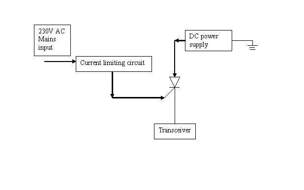

the main reason why Im interested in this thyristor is because of its continuous output due to a pulse on the gate. Please see the diagram below.

In all the datasheets Ive seen, the Thyristor gate has a DC input and switches AC load.
Is it possible to have an AC input and switch DC load?

If you use an SCR for switching the DC , how do you plan to turn off the SCR..?
I plan to put a transistor in between the DC and the SCR with its base connected to the Gate terminal of the SCR.
Therefore, when there is a current on the gate, the transistor (works as switch) will conduct and so will the SCR.

Sorry, that will not work...transistor idea.
Once the SCR starts conducting, you will have to switch OFF the DC to stop the SCR conducting, they are not On/Off gate controlled switches
How come? cos if the switch is open then obviously there is no connection between the supply and the SCR. hence wont the SCR stop conducting as there is no DC supply(i.e the DC is not connected to the SCR).
What are your thoughts on this??
If you just want to turn on the SCR with a transistor/resistor combination, thats possible.
If you realise once the SCR is on/conducting you have got to disconnect the DC voltage to SCR's Anode to turn it off thats OK.
