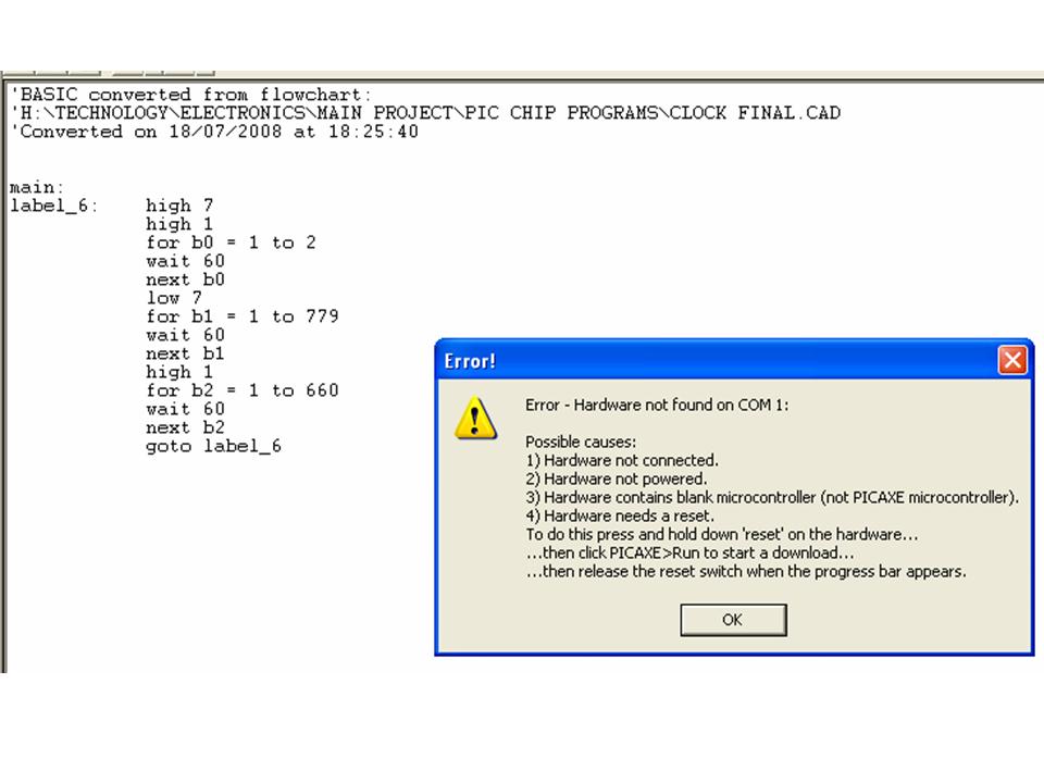

right well thanks for everyones help, especially eric gibbs. I actually get it now, and have moved on to making melodies just for fun. Anyway heres my final clock
main:
label_6: high 7
high 1
for b0 = 1 to 2
wait 60
next b0
low 7
for b1 = 1 to 779
wait 60
next b1
high 1
for b2 = 1 to 660
wait 60
next b2
goto label_6
It will send a high pulse at night time (activated at 18.00 hours). I have just been mucking around with the pic chip, doing various short time scale versions of this an expirimenting with loops and now I cant upload this final one. Heres what its saying in the screenshot. Hopefully you could help, its the schools equipment. Hope I havent broke it. I am assuming I will have to reset, but I dont want to wipe the picaxe boot code things. Cheers
