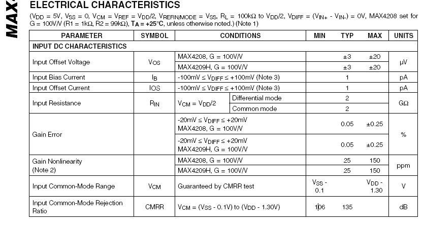

I thought what you are describing I have already done with my 2.5V reference going into the REF pin of the IA op amp.
Applying the floating 2.5V to the REF input does not guarantee that the inputs of the 4209 are within their allowed Common-Mode range. The Common mode range allows differential sensing with the inputs down to 0.1V below Vss and up to Vdd-1.3V. You have two options. Tie floating ground to either end of the sensing resistor; or tie floating 2.5V to either end of the sensing resistor. Which end you tie to it will alter the sign of the current sense.

Sorry I missed your post Ubergeek. I have looked at hall effect sensors, but they don't provide the accuracy i need (16 bit). I don't think its a very expensive method. Accurate hall effect sensors can be very expensive as all.
Mike, I understand the common mode voltage range of the IA. Also, for some reason, Zetex doesn't state very good accuracy on their datasheets (1-2%)
So you don't see a problem in the way I tied the floating ground in my last schematic?

Mike, I understand the common mode voltage range of the IA. ...
You HAVE NOT solved the COMMON-MODE problem! You have created a "floating subsystem", which if you measured its capacitance to earth ground would be on the order of a hundred pF (or more). The only thing that can CHARGE that capacitance is the input bias current (few pA) of the Inst Amp. Calculate the time constant of 100s pF and few pA.
In order for the Inst. amp to correctly amplify the differential voltage across the shunt, the floating supply HAS to BE AT the SAME POTENTIAL as the line the shunt is in. That requires a direct connection between the floating supply and the line! All the REF input does is center the output of the InstAmp into the middle of your ADC range.

I am thinking of going with another opamp (Maxim 4208). Its an indirect current feedback IA as opposed to a three op amp design which doesn't do well at the rails like you mentioned.
I posted my latest schematic. I also added a butterworth filter after the IA. What do you think? The cutoff frequency is 600hz for the filter.
  • ADC_Max.pdf
Ok, you are now centering the differential voltage in the common-mode range. The anti-aliasing LPF is a good idea. The ~100pf comes from all of the incidental capacitance between the floating subsystem and the non-isolated side stemming from the capacitance between the primary and secondary winding of the transformer used to create the floating power supply, the capacitance across the ADUM1401, and all of the strays... You have now effectively shunted that ~100pF with 2.5K (your 5Ks in parallel).
