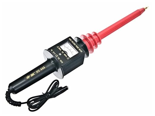

This kind of accuracy wasn't important, it was just to get an idea where the unit is set from the factory and kind of get it in the middle of the adjustable range. I was hoping for a quick and dirty (safe) method of doing it was all. I really didn't want to get into a construction project that in all probability will never have the need for ever again.
This was more of what I had in mind, but again outside my budget. BK Precision HV44A

Yeah these probes can be very expensive especially for one time use.
Maybe you can find a used one somewhere like on eBay (I don't use eBay though).
