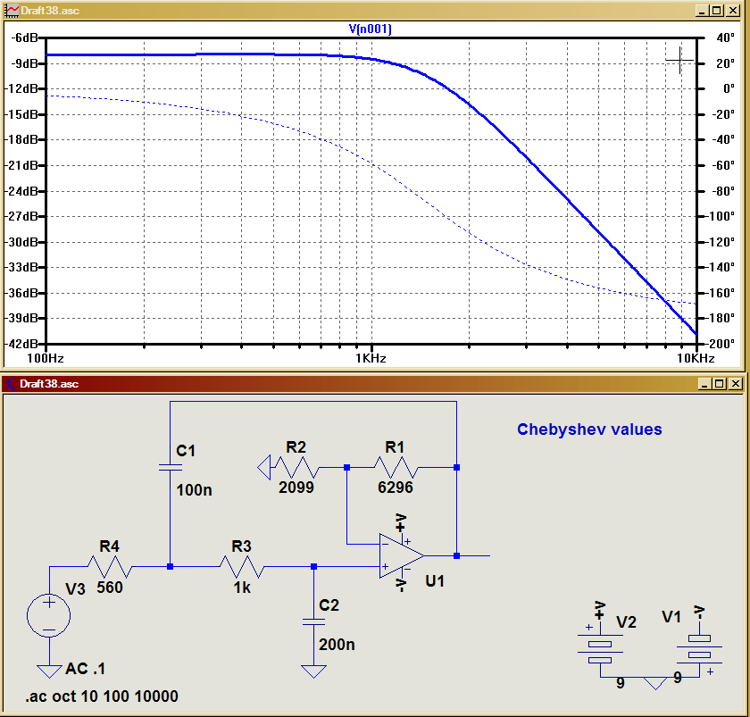

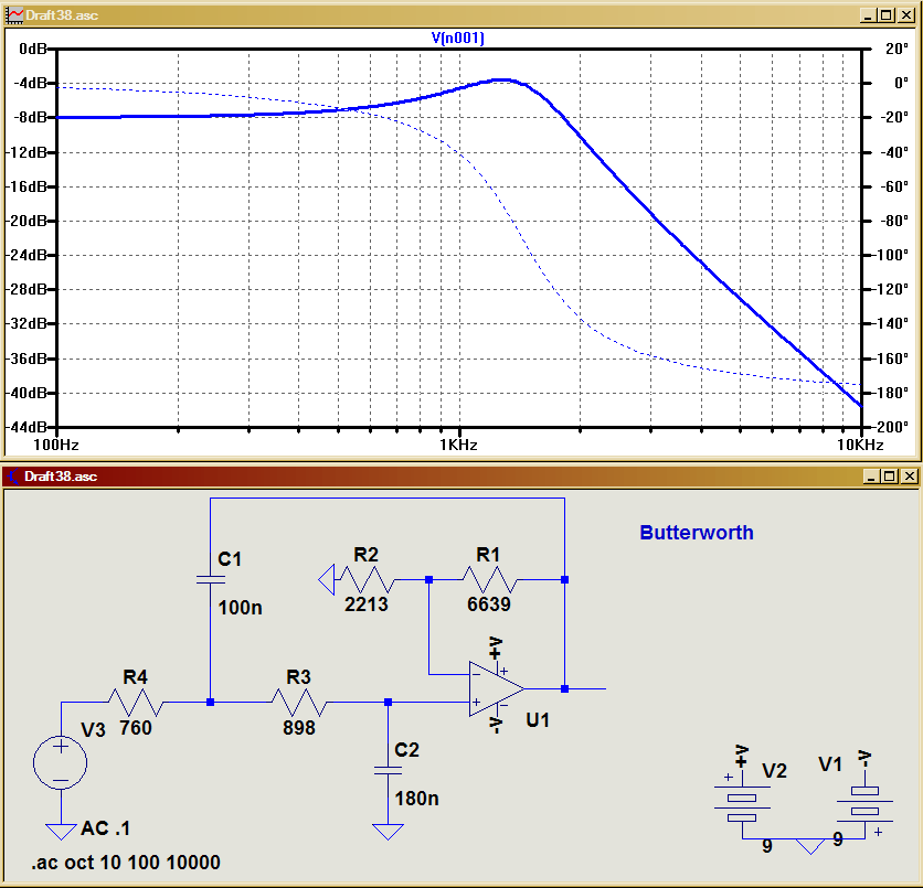

hi
Using your circuit and the two lists of values, this what LTspice shows, dosn't look like 40kHz to me, closer to your calc of 1.4K

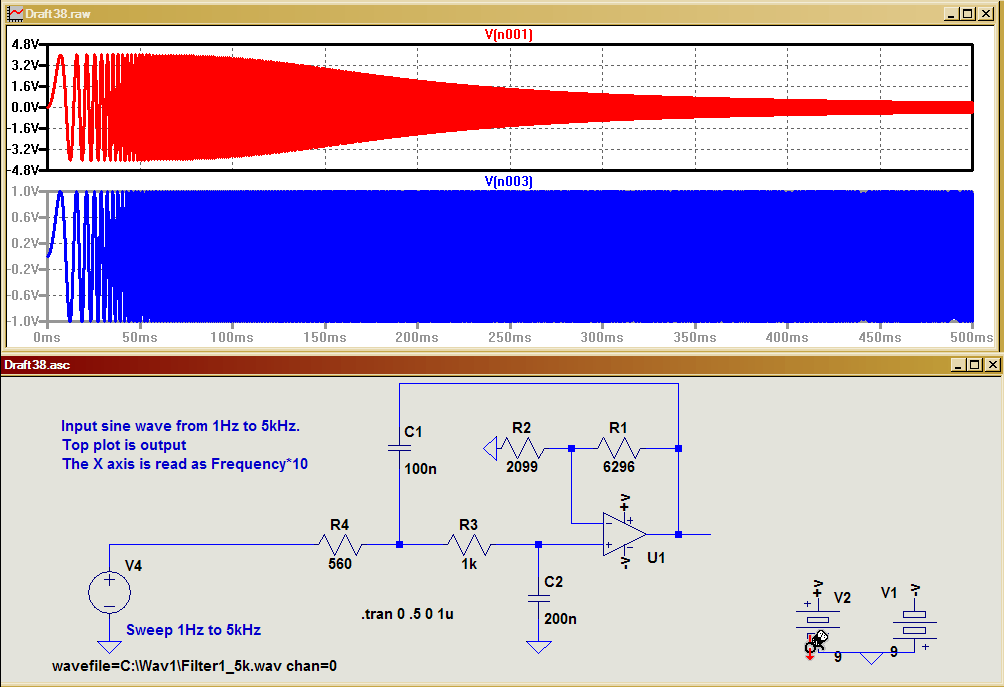

I have run some more simulations using LTspice with your circuit, it looks very close to what I would expect.
How are you measuring the inputs and output signals.???
EDIT:
This image is using a 1Hz thru 5kHz sine wave sweep
