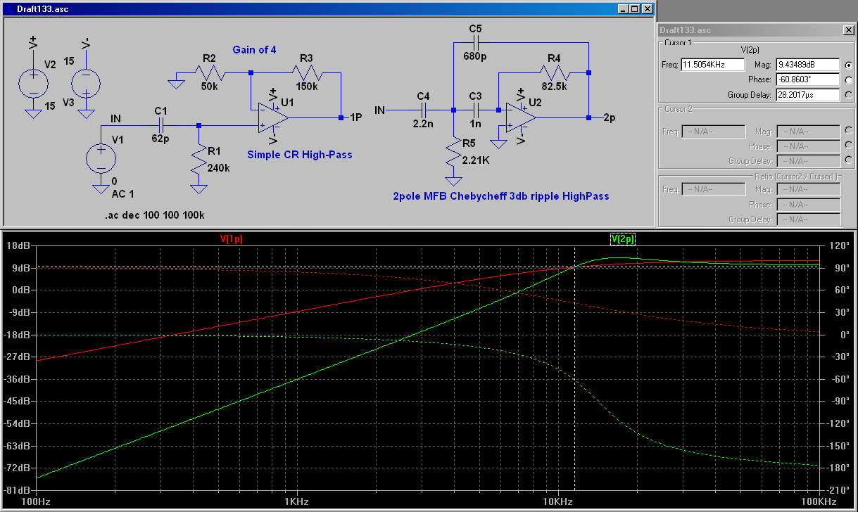

I see. Well I've put 12.5kHz hashmarks in a recording and want these and only these markings to be stepped up and outputted via transformers to electrodes. It's kind of a simulated bpm that I've introduced via hard disk sequencer that I mixed into the audio track. So in essence I don't want anything lower than the hashmark frequency to make its way to op amp and transformer portion of circuit.
Here is a comparison of a simple C-R followed by a gain of 4 to an 2 pole active filter, gain of ~4, MFB configuration, Chebycheff w/ 3db ripple.

MikeML: so the green line is the 2 pole Chebycheff circuit? I think I prefer that design. I'm using Radio Shack's LM386 low voltage audio op amps, is this adequate for the 2 pole design? By the way, which application is that?
The solid green line is the voltage at node 2P (in db relative to the input V(IN)). The dashed green line is the phase relative to V(IN).

The simulation was done in LTSpice. I used FilterPro to get the values.
