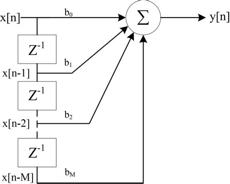

You are on the right track. FIR very simple architecture :
So you have a delay line (memory) where each sample is input (after) shifting
all the prior samples (N samples) and recompute the sum of all the taps. The
b's above are the coefficient values)
Regards, Dana.

So basically, that would be the design, right?
Or am I missing any other "component"?
Thank you so much for the help and for responding! :)

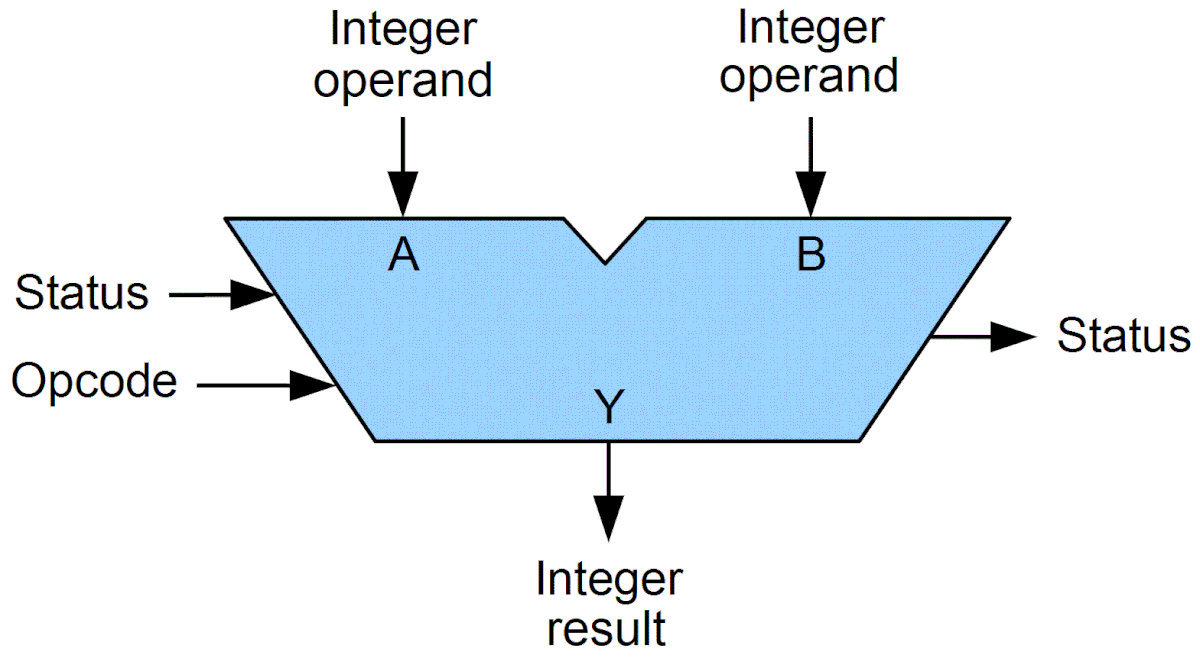

Of course you need A/D front end, and a LPF filter to masnage Nyquist related issues.
You can do the filter in code and or HW.
Your adder wants to be an ALU of some sort.
Take a look at old time 2900 family ALU, it was quite the rage (speed) before
MOS bloomed in capability.
Or use a single chip that has all the elements and routable (simple with wizard).
