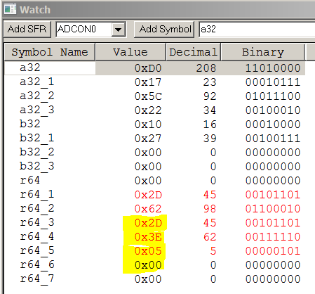

I think i found a reasonable way to calculate the control bytes with no loss of accuracy.
First, we use type unsigned long long math. Type ULL is a 64 bit unsigned number.
The magic number in hex is:
M=0000 0022 5C17 D02B
and as you can see that is a 64 bit number and has some leading zeros.
All we have to do is multiply that number by the frequency, and then grab the upper 32 bits of the result (ignoring the lower 32 bits).
For example, for 10MHz we have:
F=10000000;
C=M*F;
The entire 64 bit hex result is:
147A E147 9969 4780
from which we can grab the upper 32 bits (and round if the 9th digit is 8 or above if we care too, but i wont round here):
147A E147
and so the control bytes are:
14, 7A, E1, 47
or:
14, 7A, E1, 48
if you care to round.
For another example, 1000Hz:
C=M*F;
the 64 bit result is:
0000 8637 BD05 27F8
and grabbing the upper 32 bits we get:
0000 8637
and if we care to round we get:
0000 8638
so the control bytes are 00, 00, 86, 37 or 00, 00, 86, 38.
Looking back at some of the previous posts, i see you may have done something like this already just with a little less precision, which still isnt bad :)
For 10kHz i get:
0005 3E2D 6233 8FB0
and so the control bytes are: 00, 05, 3E, 2D with no possibility of rounding, which is the same result you got for 10kHz.
Ah... Adding code for rounding fixed the problem I was having.
Thank you... Mike
