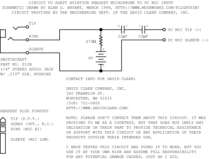

Hi there,
As we know that PC Microphone is not Amplified, and Aviation Microphone is amplified.
I need to make an adapter from PC headset microphone to Aviation headset microphone.
I have the diagram for Aviation to PC headset, just I need to reverse this thing.
Thank you..
Remove the battery and battery series resistor. You may have to experiment with the series capacitance for frequency response. Higher C, more lower frequencies are amplified.
Completely wrong!
A PC headset mic is an electret type that must be powered for it to work. It needs to have a preamp to work in an airplane and the preamp also must be powered, usually from the jack it connects to.
An original old aviation mic was a carbon type that needed a fairly high current from the 9V battery and 470 ohm resistor to work into a PC. Its output level was high enough so it didn't use a preamp in an airplane.

The Op wants to feed the very low output of an electret mic (that must be powered and amplified) into an aviation mic input.
So the mic and its preamp must be powered.
