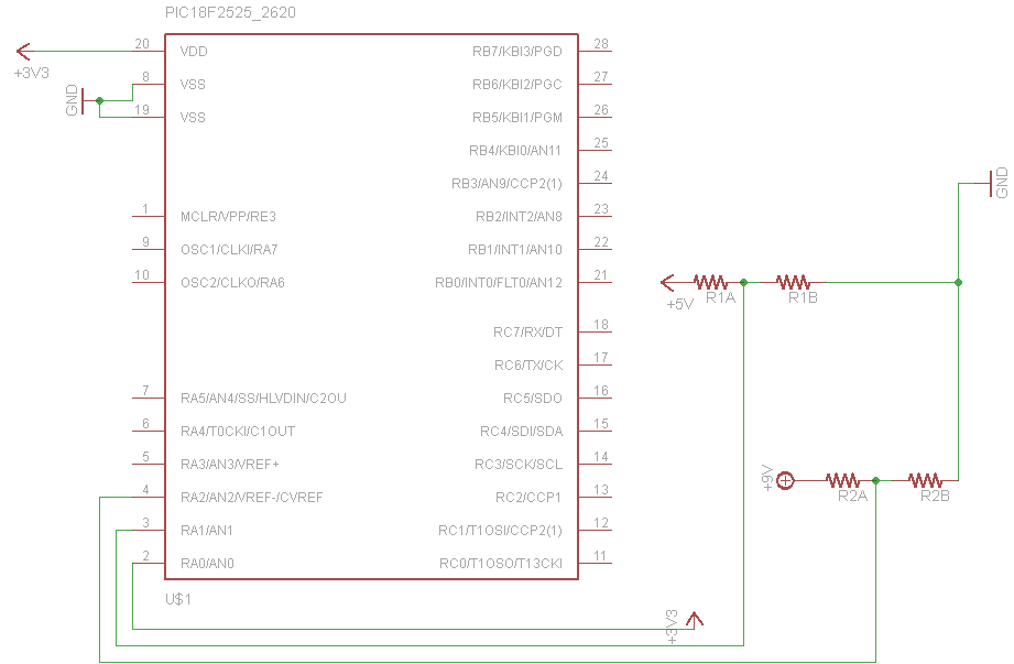

Ok maybe i should explain more lol
I want to create a master power supply which will have 9v, 5v, 3.3v
i just want to show on a LCD that the correct voltage is coming from each source. So my VREF would have to change am i correct? From the 9v source(dropped to 4v-5v) and my 5v VREF is ok, and my 3.3v VREF would be fine.
I am tired once again lol
. in fact ill make a quick schematic ok
Remember i still of course need to find values of R1 set and R2 set of resistors. I know there are online calculators for such things.
But would this be around how its done...?

That would be fine. As long as the 3.3V for the PIC's Vdd (pin 20) comes from a separate regulator. I would also add a resistor in series with pin 2 (RA0/AN0) of the PIC in case something causes the 3.3V line to be pulled higher than 3.3V (A power supply fault or someone feeding 12V into the 3.3V output, etc.)
You could also run the PIC on 5V if you wanted to.
No, your VREF will not have to change, and if you have the pins, it will be easier and cheaper to use 3 separate ADC inputs to read the 3 voltages instead of using 3 transistors to switch between them.
However, as someone else pointed out, you cannot use the same 5v as your reference as you use as your 5v power source. The reason is because as the 5v power line droops, your 5v reference will droop, and the ADC will result in the same value.
I just formatted my computer so I can't draw a good schematic for you, but here's an example of my awesome MS Paint Skillz yo
Just use a voltage divider, read the ADC value, then pass it to the function and it'll tell you what the input voltage is. Generate the 3.3v reference from an LDO off of the 5v rail.
Edit: Beat me to it, but yeah, we're on pretty much the same page. And if you want to read 3.3v on the ADC, and you're using 3.3v as power/reference, then you should put a divider on the 3v line as well otherwise you won't see if its above 3.3v.

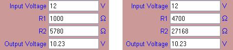

Im not sure what you mean by "10.23V on each input" ?
If i never reach 10.23v... Or do you want me to set it up in a way that i can test upto 10.23v on each input and all be the same. Would this give me ok results for the 3.3v?
If so a 3.3v would give me a value of 0.033 correct?
Using a 12v Supply and making a divider i can use ..
R1 = 1.2k
R2 = 7k
OutV = 12.244v is that close enough?

I think what he means is use a voltage divider so that if the input voltage were 10.23v, the voltage at the ADC pin would be the same as your Vref. I never considered doing that, and I like the fact that all you have to do is divide the ADC value by 100 to get the voltage, but I disagree with his reasoning behind it. The micro will hide the math from you, so unless you're pressed for cycles or flash space, I wouldn't worry about it. And you only have to show the digits that you want to show.
But I write 99% of my code in C, so it's quite easy for me to do that.
Calibrating the hardware is old school, and really nice for when you are using assembler and need absolute minimum code size etc.
But if you're using C I agree with Noggin (although I don't agree with his haircut ;))
I would choose voltage dividers that give the max resolution of the ADC, and calibrate in software. In C the math is easy, and you can average multiple samples and get even finer resolution than the native 10bit for the ADC.
Assuming you are using a text LCD you can add as many decimal places as you like. It will still only be as accurate as the calibration and ADC drift etc but the extra digits look very cool and will still show some PSU voltage conditions like sag and heat cycling etc.
If you average readings over a fixed period of one complete mains cycle the ADC will average all the ripple, giving you finer resolution because of the varying values and it will also give you a more accurate DC voltage reading (ie the average will also negate the ripple).
You're both missing the point, it's not about avoiding the math (which is trivial in assembler anyway), it's about avoiding the messy results it produces - as shown in the examples I gave.
Doing it the way I suggested gives a display that increments in a perfectly linear fashion, 0.01V, 0,02V, 0.03V etc.
Doing it by scaling with maths produces a horrible progression, unless you reduce the displayed resolution to LESS than my method. As his required voltages are all under 10.23V it's a perfect simple solution.
I fully understand your desire to use the full range of the ADC, but that's going to produce a poorer resolution than this simpler method - or a really amateur looking display.
Ok, I made a spreadsheet and I see where you're coming from.
With your method, by definition, a voltage input of 1.67v would give an ADC conversion of 167. The voltage calculated from that would then be 1.67v.
If I were to do it my way, I would scale the voltage divider so that at a 5v input to the voltage divider, I'd get a 3.0v input to the ADC (using a 3.3v reference). A 1.67v input to the divider would put 1.00v at the input to the PIC. With a reference of 3.3v, that would come out to a conversion of 310. After converting back to the original voltage, I would get 1.66v instead of 1.67v.
So, by decreasing the resolution you increase the accuracy. Somewhat counter-intuitive if you ask me. So do you have those magic resistor values handy for 3.3v, 5.0v, and any other voltage references? :)
Looks like 9.76k and 4.64k would make a good divider for a 3.3v reference and 10k and 9.76k would work with about 1.1% error for a 5v reference.
