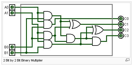

If there were 8x8 bits instead of 2x2... Just imagine how big it needs to be..

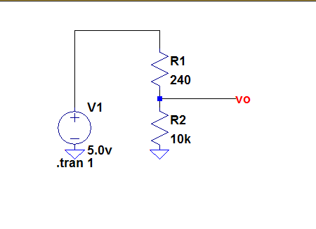

A way I use is a simple resistive divider in the ADC input.
It drops the 5V down to 4.88V, which gives an ADC count of 1000 for 5V.
Then add 5 readings to give 5000 for 5Vinp.

Use 1% resistors or a 500R trim pot for the 240R
You have not said what the output impedance of your 5V test source is.???

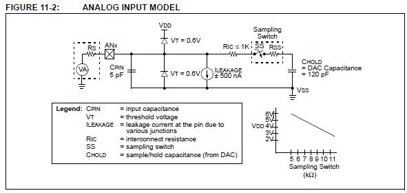

Dear ericgibbs,
Thanks for the reply
As per datasheet the impedance is The maximum recommended
impedance for analog sources is 2.5 kΩ.
I think in the picture it shows as "RS"
It would be much appreciated if you can explain more theory related to the picture

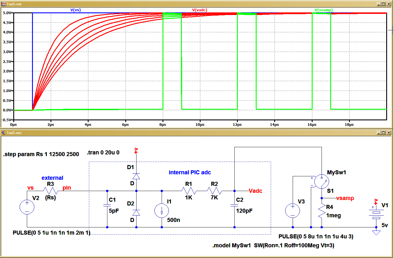

I did this LTSpice simulation some time ago in order to show the effect of RS [Source Impedance] and the sampling time, when the ADC input was a 0V to 5V step voltage.
Some PIC's are recommended for use at a 2k5 or a 10K maximum value of RS.
The attached sim plot shows a RS of 1R thru 12500R in 2500R increments.
The question I asked you was, what is your expected RS value.?
Basically what are you using the ADC for.??

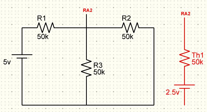

I used 100k variable resistor for ADC, RIGHT pin for VCC and LEFT pin for GND and middle pin to RA2 of PIC ( Analog input)
Please advice
...I used 100k variable resistor for ADC, RIGHT pin for VCC and LEFT pin for GND and middle pin to RA2 of PIC ( Analog input)
Please advice
With the pot wiper at the middle, the Thevenin equivalent circuit is a 2.5V source in series with a 50K resistor (half the pot value). This clearly violates the maximum 10K source resistance spec for the PIC's A/D input pin. You should use a pot no higher than 20K. Note that the worst case spot as the wiper is moved occurs at the half resistance point.
Dear MikeMl, Thanks for the reply
I drown a simple circuit which connected to RA PIN. Finally we have to find the Th-evening Equivalent cct.Values using Maths.
In my drowning three resisters represent single pot wiper
Can you please advice, I am in correct tract
Please advice

As long as you're only using one analogue input then there's no real concern about the source impedance - the problem isn't the input impedance of the pin, but the time it takes to discharge or charge the sample and hold capacitor via the source impedance. This only really causes problems if you're switching between different inputs, you have to allow substantial time delays for the charging/discharging to fully take place.
But as you're just using a pot, why not use a sensible value one anyway? (4.7K/5K would be good).

Dear Nigel Thanks for the reply and advice.
Actually I try to implement and understand the The Thevenin theorem using real practical situation which is we learnt in the class room as a theory. In the above my post 56, I tried to drown a equivalent circuit related to preset. What do you think
Am I in the correct drowning??
