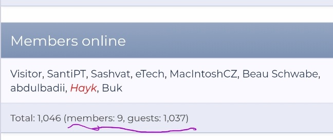

This forum is largely comprised of grumpy old men. Attracting new members is kind of vital to keeping it alive. People asking honest questions should be guided along. Sure, many of the questions posted here can be easily answered by Google....if a person knows what to search for. Sometimes, questions are asked as a reality check. Just because "the perfect solution" shows up in a search doesn't mean it's the best solution for a particular problem, or sadly, it may not be a workable solution at all.
Just in case you have doubts about the need to encourage new members, look at the member/non-member distribution. It's somewhat skewed by the time of day, but the number of visitors always outnumbers the number of members here.
If you've ever been inundated by the ads you see when you're not logged in, you might wonder why more viewers don't sign up to be members.
Yup, short term gain for long term nothing. Very short sighted. To be fair, most guests are robots. BUT.
