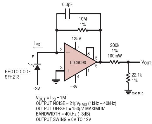

Trying to use a simple light level detect for something like that often gives problems.
The better method is to use modulated light, eg. switch the LED at a moderately high frequency such a 1KHz or 10Khz, then capacitively couple the signal from the detector via simple high-pass filter from the detector & amplify that.
It eliminates ambient light levels from the system and gives better operation over a wider signal range.
Also look at active photodetectors for the input stage rather than just a simple bias resistor, eg.
https://www.analog.com/-/media/analog/en/circuit-collections-images/ltc/610-circuit-1.jpg
