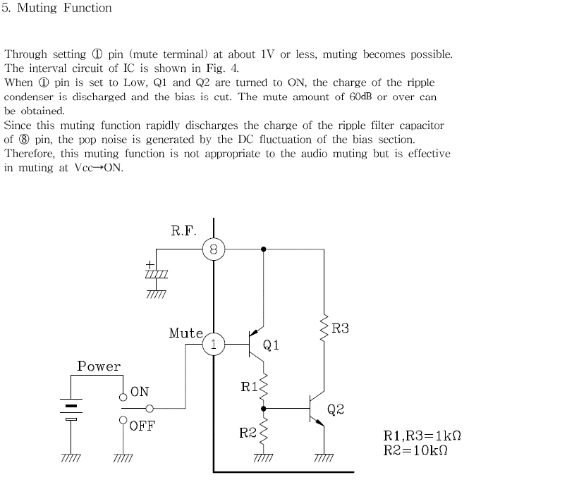

Just a quickie - I've found an IC I am going to use to build a 12V dual audio amplifier.
Here's the PDF for the IC:
https://www.digchip.com/datasheets/parts/datasheet/247/KIA6210AH.php
I'm going to copy the test circuit for my amplifier, since I'm no circuit designer. One problem though, I don't understand what it means when discussing the mute function on page 8 of the PDF file.
How do I make use of it when it's in circuit, and, if it's easier not to use it, how do I do the circuit so its function is not used?
I'm not going to use the standby function, I'm going to have a switch across the VCC input, so I gather I just connect standby to the full VCC from the switch I'll add?
Thanks everyone,
James
Just conect it to Vcc wint 56k to 47k or ~?~ to get not more than 2V !!
Steve
