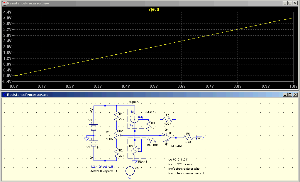

I have a microcontoller which requires a 1k min to 10k max variable resistor to access its analogue input.
The variable resistor I wish to use goes from about 0-4 ohms!
Is it possible to/how do I "amplify" the resistance from 4 ohms to 10k so that I can use this variable resistor?

The microcontroller is a Highly liquid midi unit.
I want to use one of the analogue inputs which will accept 1k to 10k variable resistor, which when varied, will control volume or pitch.
The variable resistor I have will measure up to 4 ohms (I am seeking a higher value for the material I am working with), but wondered if there was a solution in electronics by , in effect amplifying or "stepping up" the resistance,in the same way a darlington pair amplifies a signal. maybe voltage divider, a wheatstone bridge or some other mechanism that gets me to use the analogue range of the midi controller.
I am stuck with the material I am working with (it has other properties apart from its electrical resistance).
Thanks for your input, much appreciated.
You can use it by passing a small current through it (100mA if possible) and then you would get 0-400mV out. This could be amplified with an opamp and fed to the ADC input. However, 100mA maybe too much for it or may interfere with it's other properties.

Based on Pommie's 100mA suggestion, here's a circuit which I think should do what you want. I have simulated a LM317 regulator IC having a 12 Ohm adjustment resistor to create a 100mA source. This 100mA is applied to your resistor simulated here by U3/V3 (as V3 goes from 0 to 1V the simulated resistance goes from 0 to 4 Ohms). The voltage across U3 (0 to 400mV) is applied to an op-amp with a gain of ~ +10. Because the voltage being measured is small any input offset of the amp needs nulling. U2 (a 100 Ohm trimmer) handles that. Because of amplifier non-linearity close to the negative rail the amp is operated with dual polarity supplies (+-6V, non-critical).

Got the made up board based on alec's circuit diagram today.
Problem: the LM317 began to fry as soon as I switched on.
I had a look at the soldering and noticed a piece of solder shorting to pin 7 of the LM324NS, which I have cleaned up.
I also noticed that V+ and V- on the LM324NS were not connected;
I assume that they should be connected but I'm not entirely sure which pins they represent.
My guess is V+ is to pin 4 from the positive rail, and V- is to pin 11 (Ground) but which is actually the negative rail.
I may have got this completely wrong, if someone could give me a little guidance.

Hi Phil
You have it correct. Pin 4 is + and pin 11 is ground for single supply operation.

Hi again,
I have connected the V+ and V- on the LM324NS as suggested, but the LM317 continues to fry, as does the pot I'm using for testing temporarily.
I have noticed 2 other possible causes;
The 3k3 (R6) resistor is missing. I will get one tomorrow but I can't think that this would cause frying.
The variable 4ohm pot in the circuit diagram appears to short the input to the wiper, is this correct? So pins 1 and 2 are shorted and pin 3 goes to ground?
Any help appreciated.
