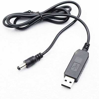

Do I still need the step up DC converter?

No. That was only needed for the 12 V strips. You are working from 5 V which is the voltage that the power bank produces.
Since ebay says it "Provides power and charges your 5V devices" not 12V devices then you should double-check with the manufacturer. But in Item Specifics it looks like the manufacturer also says "Output Voltage: 5V".
Even if their text is wrong and the output is really 12V then they do not know that a 12V battery is charged from a voltage that is higher than 12V.
Can you believe that its output is 2A or is its input 2A??
They do not know these important things.
EDIT: They also do not know the voltage of their LEDs.
