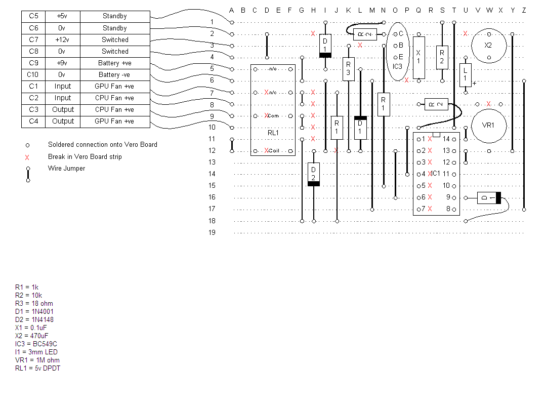

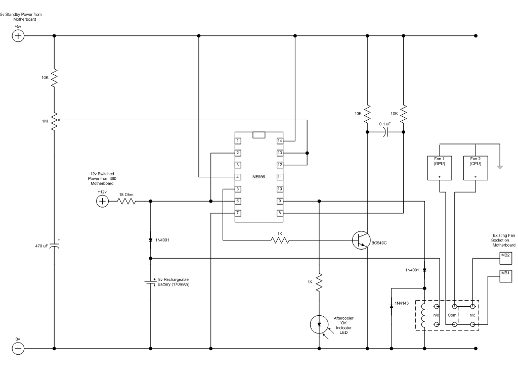

Hi Im newbie at this stuff and need help. Ive been building a aftercooler for my computer using a schematic and veroboard layout downloaded from the net. It uses a 5v standby supply (1A) and a 12v switched supply (0.5A?). The idea is when I power off the computer the timing cycle starts and clicks in a relay to change the fans over from the motherboard to a 9v battery for 4-5 minutes. At first it didn't work as it was using a 5v relay so I changed it to a 3v as the ne556 can only out put 3.3v using a 5v supply. All was working well until today when it just stopped working and I cant figure out why. Any help would be great as rapid hair loss is starting to occur! Here is the schematic and vero layout. I noticed aswell there are a few difference with the two, when building it though I followed the vero layout.

So wait a minute, your 556 has a 5v supply and your putting 12v on the inputs? You probably fried the part, hopefully you did not damage your MB.

Ive been using this for two months and not had any problems at all with the board. The points Ive taken the supplies from are just infront of the psu connector. Forgot to mention when i say computer I mean my xbox 360. The aftercooler stopped working earlier and my xbox is still running good. I tested it first on a broken motherboard for like hours just to make sure I didnt screw up my working one.
Yeah the little led worked fine all the time. Now the led doesnt come on anymore . Although when having a poke around with my meter I triggered the timer by accident and the led came on . Did this a couple times, seems like its doesnt do this automatically anymore, do know why

Maybe I am missing something. From the schematic, it looks like 12v is directly tied to pin 2 and 6 of the 556. I see a potential latch up condition here.
No, you didn't miss anything Mike. I did! :(
There certainly is 12 volts applied to the 556, I can't say I would have done it that way.

I did some more poking around lastnight after reading what mikebits said about the 5v supply and the 12v inputs. From my understanding the 556 is being used as a inverter and timer cycle. when powering off the 12v line the led would come on click in the relay and then time out but It doesnt do this anymore when powering off. when having a look last night after I powered it off I accidently grounded pin 6 (trigger) and the timing cycle started and clicked over the relay. Does this mean mike was right and I fried the inverter side of the 556?
would dropping the 12v to 5v for the inputs on the inverter side rectifiy my problem? Any ideas or suggestions for improvement I would be most grateful!!

Well, it seems that Microsoft has acknowledged a reliability issue on the mobo. Most notably that the CPU bga device loses connectivity of some pads due to rapid temp changes after CPU is turned off resulting from board warpage, so I wonder if adding a cooling fan would only hasten the warpage due to a rapid cooling.
Other questions I have are; Is not that cpu fan rated for 250ma @ 12vdc, how well will it run at 5vdc and how much current will it draw? Secondly, what is the power sequence timing? That is when is 12v de asserted in relation to when 5vdc standby is asserted, and lastly what is the current drive of the standby 5vdc ?
