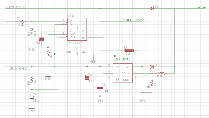

Okay, I thunked on this a bit and I think I came up with a circuit that will do what you want.
See attached. The way it works, or supposed to work is as follows:
On pwr up, IC1A is reset and not triggered. Xbox_12vdc is present and provides power to fan through D2. On power off, Xbox_12vdc goes low and enables max1896 5v to 12v converter and the 12v is is supplied to the fan via D1. After preset time IC1A /Q goes high and disables max1896 thus fan shuts off. See diagram. I did not work out all the values and such but this is a starting point. Let me know if your interested in me going further with this.
https://www.electro-tech-online.com/custompdfs/2010/06/MAX1896.pdf
BTW, D1 and D2 should be of schottky type.

I do understand how this works, but I do have a few questions. What is the item that connects Pin 2 on the 74LS123D to ground. It looks like it is labled C1P, but I can't really read it.
And how will the fans get the nessacary amps. They run on .4 amps each (there are two), but the Max 1896 only outputs .3amp at 12v. I am not opposed to running only one fan, because that would definetly make the cool down more gradual
Mike
C1P is the power pins for the LS123. Eagle Cad does it that way. Did not know there were 2 fans, darn.
