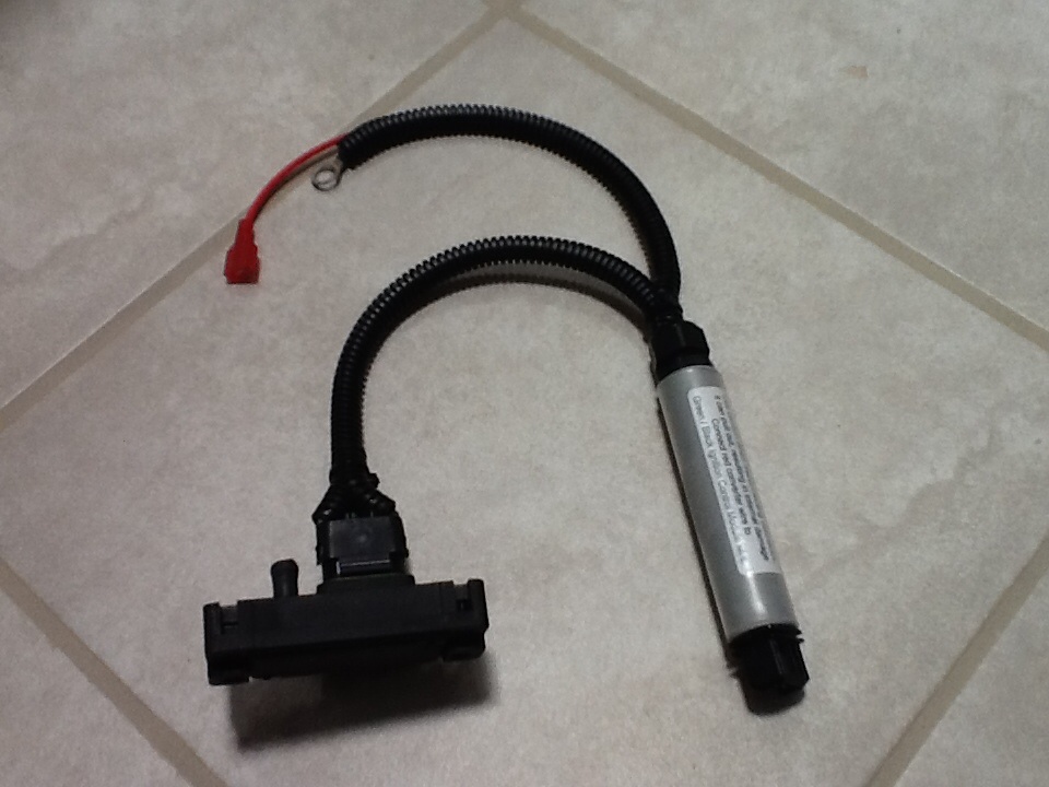

Hello again, everyone!
Seems like many months (wait a minute, it has been many months!) since I made time to check in with folks here who generously shared their knowledge and experience on the subject of automotive sensors and controls. The previous post, by new member (and new Alfa owner) Shawn Williams reminded me of my negligence. Shawn and I talked at length this afternoon (truth be told, Shawn did a lot of listening and I ran my mouth.)
To refresh memories, this post began with my request for assistance from the collective wisdom of the group in designing a replacement for the failure-prone electro-mechanical Vacuum Sensor Device (VSD) in Series 3 Alfa Romeos. The VSD, as you may recall, sends a signal to the Bosch L-Jetronic Ignition Electronic Control Unit (IECU) where, based upon engine load, additional timing advance is generated.
While ETO member K.I.S.S contributed a considerable amount of time and effort to the project (thanks Ron!) my lack of follow-through and fading enthusiasm ultimately closed that avenue.
So here's where things stand.
In the spring of 2013, Bob, a retired control engineer I met on another technical site, became involved in the project and, after digging into the Bosch IECU I sent him, extracted long-forgotten secrets buried deeply within the electronics. Bob learned the variable inductance of the VSD is connected to a variable oscillator in the IECU which subsequently results in modification of the engine's timing advance. Through further wizardry (and an engineering degree and decades of experience) Bob designed and built a prototype device, which I have cleverly named BD-1.0. Without an Alfa in his garage (Bob doesn't know how fortunate he is in that regard ) to test his device, he could only assure me that the IECU oscillator responded to BD-1.0 very nearly the way it responded to a know operational VSD.
Bob's design is currently in my hands and after I install a new fuel pump in my Alfa, a few tests should confirm that his design is a success!
Lesson learned (one of many). Do not assign projects to retired guys with grandkids and actual lives. All seriousness aside, the major foot-dragging was on my end and sincere thanks to Bob for his dedication and long hours.
Film at 11.
Bob's elegant work, and yes that's an analog, off-the-shelf MAP sensor. The main connector even matches OEM!
