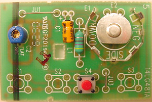

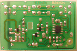

I have a garage remote control. (Liftmaster 971LM)
It operates off a 3 volt battery.
I don't know anything more about this.
I have tried to modify this to to operate directly off a 12 volt battery but I'm afraid it will fry it.
I have two wires soldered to where the battery connects for the direct contact.
Now, how can I do this?
I want the cheapest and easiest way possible.
Can I solder some type of resistor in-line to drop the incoming voltage?
Let's see who can help!
Oh and gentlemen, please understand that I know nothing about electronics so please explain in detail.
Thanks Guru's!!!!

Basically, this is what I have.
I have a genie remote that operates off a 12 volt battery.
I have a liftmaster remote that operates off a 3 volt battery.
I want to be able to drop the volts down on the 3v Liftmaster, STILL using a 12 volt battery.

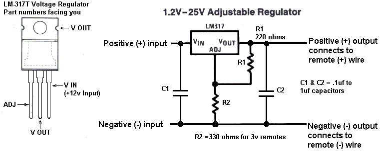

Yes, the trusty old LM317 or cost and space saving LM317L will both do here.
The circuit is on the datasheet.
Below is a copy and paste.
Will this work?

Just curious, If this remote when used with 12V and a 45k resistor had 0.5V accross it then that would show it's drawing 0.256mA and therefore it's internal R of is 1956ohms, So when running at 3V this would mean it's drawing 1.53mA, that's about 1/10th of a CR-2032's pulse current. If we tried running it at 12V with a 5.8k then wouldn't it work???

I disagree, a zenner isn't the best way to do this because the quiescent current would be far higher than an LM317, therefore it's a waste of power.
The remote draws 0.256mA with a 0.5V supply. I don't think it works properly with only 0.5V. Its current will be completely different when it is operating properly with a 3V supply.
The voltage regulation of some 3V zener diodes is crap and depends a lot on its part number and on its current. If the remote is not being used then the zener (and the remote) will have 3.5V. If the remote draws 50mA when it is working then the zener's (and the remote's) voltage will drop to 2V or less. Use the LM317 voltage regulator.
