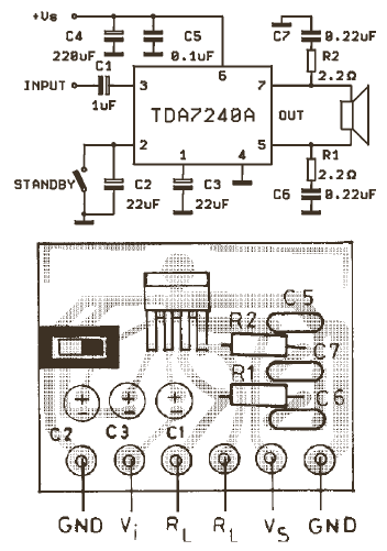

Hello,
My car's radio is dead. i've identified all the wires going to the speaker, 12V power (and also the wires for volume control near the driving wheel)
What i want to do do is simply to connect my MP3 Player, or any audio output to the speakers. Sure, i'll need an amplifier for that, and that's why i am asking for your help: I know nothing about audio!

The speakers are 4 OHM speakers (there are only 2 speakers)
I have a lot of TIP transistors.. hope i could use those ones if i have to build a circuit.

I've found this circuit:
It seems simple enough for me to be understanding what i do. but not enough powerfull, what would i need to do to boost it power a little?
Also it use TIPs, so good, but can i use TIP122 instead? (i don't have TIP31).. what changes would i need to do?
You found a very distorted very old amplifier circuit that might produce 1W into a 4 ohm speaker.
A cheap amplified speaker with a 12V adapter probably has an output power of only 1.3W into an 8 ohm speaker. A 4 ohm speaker will blow it up.
A car's electrical system is usually 13.8V. A bridged car radio amplifier IC has an output power at clipping of 14W into a 4 ohm speaker. The bridged amplifier is two high current amplifiers with each one driving each end of the speaker for nearly double the voltage across the speaker. Then the power is 4 times as much as a single amplifier circuit. The speaker is 4 ohms then the current is double the current of an 8 ohm speaker for additional power.
The TDA7240A amp IC is easy and the pcb design is in its datasheet.
Blow it up speaker or amplifier ?
Nearly anything will blow up a cheap speaker.
An amplifier that is designed for an 8 ohm speaker will try to drive double the current into a 4 ohm speaker. The over-current will blow up the amplifier.
